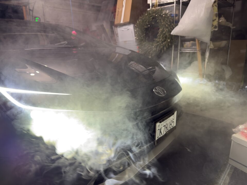

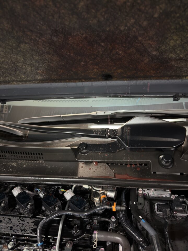

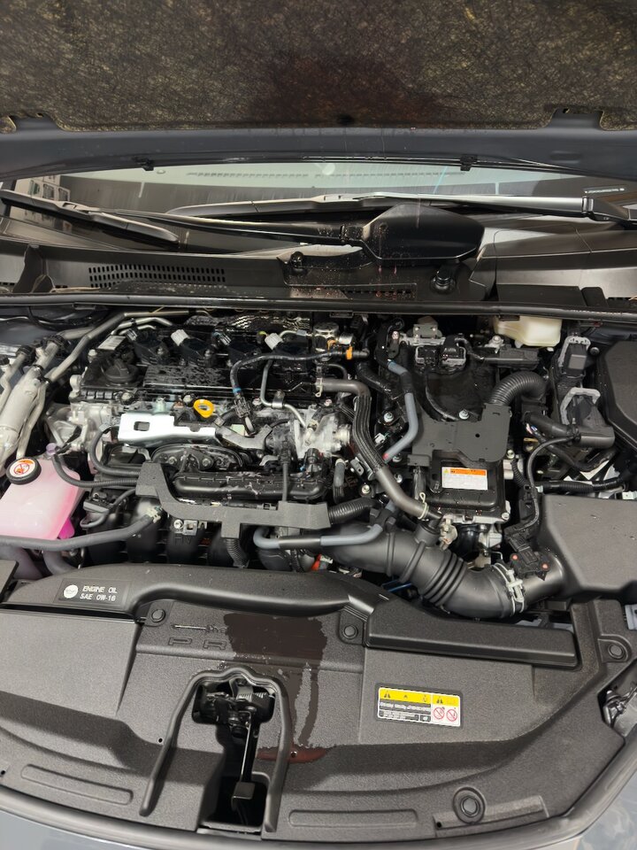

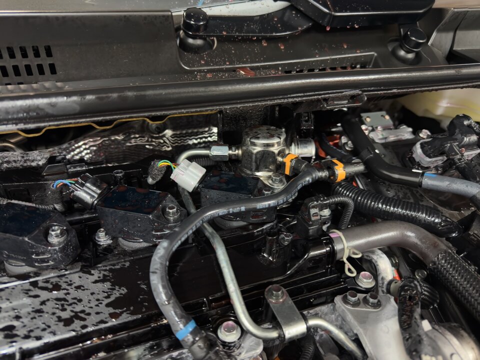

    Car purchased on 4 October 2024, 26 days ago. 1,536 miles. Got home tonight to see a heavy fog spilling out of my engine hood, like there was dry ice and water mixing. I opened the hood to find pinkish fluid sprayed up and throughout the engine compartment. Is it the water pump? Coolant? Should Toyota replace all the soaked insulation?

    Some part of the cooling system failed. Don't drive it. Have it towed to your dealer instead.

    Just for curiosity, you could look at the two white plastic reservoirs on the passenger side and see which one is low. That will tell you if it was engine coolant or inverter coolant that sprayed all over. It's physically the same stuff(Toyota Super Long Life Coolant), but the two coolant systems are separate from each other.
    Considering how new the car is, I suspect either rodent damage or a defective or improperly attached coolant fitting. If it turns out to be Toyota's fault, you can try to see if they'll replace the hood liner, but honestly all it will need is a light pressure washing and drying.

    I would suspect engine coolant, I don't think he would've made it 1.5K miles if it was the inverter coolant. I believe that's a low pressure system vs the engine coolant is running at higher pressures, so more likely to pop from defects in those plastic connectors. But who knows; I could be wrong....o_O:rolleyes::sleep::giggle:

    Judging from the stain on the hood insulation; The leak is somewhere center rear engine towards the fire wall. Near or around the #4 spark plug. The fog effect was coolant dripping onto the hot exhaust manifold.
