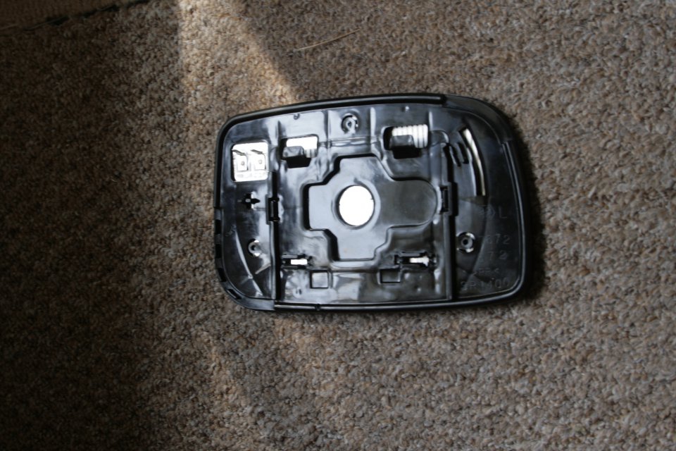

    Hear is a picture of the back of the mirror. The two claws that hold it at the bottom edge can be seen. These grasp very tightly onto round bars. The two hooks at the top of the mirror come free as it is tilted up. I hope this will tell you if they are the same or not.

    Thanks so much for the picture John. This confirms that this is NOT what my mirror looks like. This must be from a manual mirror, or perhaps from a different year. Mine is completely different - there are no round bars that it snaps on to. But at least I now know for sure that the "grab and pull" method will not work.

    The picture is from the mirror off my 2008 Prius with electrically operated glass movement, and is the same on all G2 model years as far as I am aware. Unless your car has electric folding mirrors that I believe were only fitted in Japan. I could be corrected here they should be the same.

    OK, I think I figured out what's going on here! It looks like the mirror I have is an AFTERMARKET mirror. It must have been replaced by the previous owner. Because when I compare it to the passenger side mirror it is different (my passenger side mirror looks like the one in the picture above). And the passenger side mirror has a Toyota part number stamped into the black plastic on the underside, whereas the driver's side mirror does not...there is no part number at all. And the 3 screws on the underside of the Toyota part are Torx screws but on the other one they are Philips screws. So even though both mirrors look identical on the outside their internal mechanisms are completely different.
    So I think this explains my problem. And I do believe the glass on the aftermarket mirror is glued on so removing the glass without breaking it is impossible.
