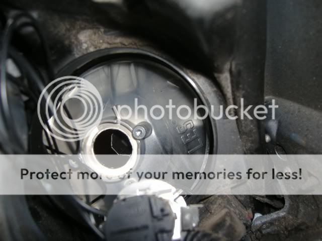

    OK so the Prius Gen III has a headlight consturction similar to this:
    Because my previous cars (Audi, BMW, Infiniti) all had headlights like these..
    If you notice the bulb housing where the bulb goes is actually inside the headlight. So with my BMW since it was the only one not to come with Xenon or HIDs, I had to drill a hole to put the wires through to the Ballast.

    Don't worry about drilling any holes. All the wires are accessible without any modifications. :rockon: You'll be fine.
