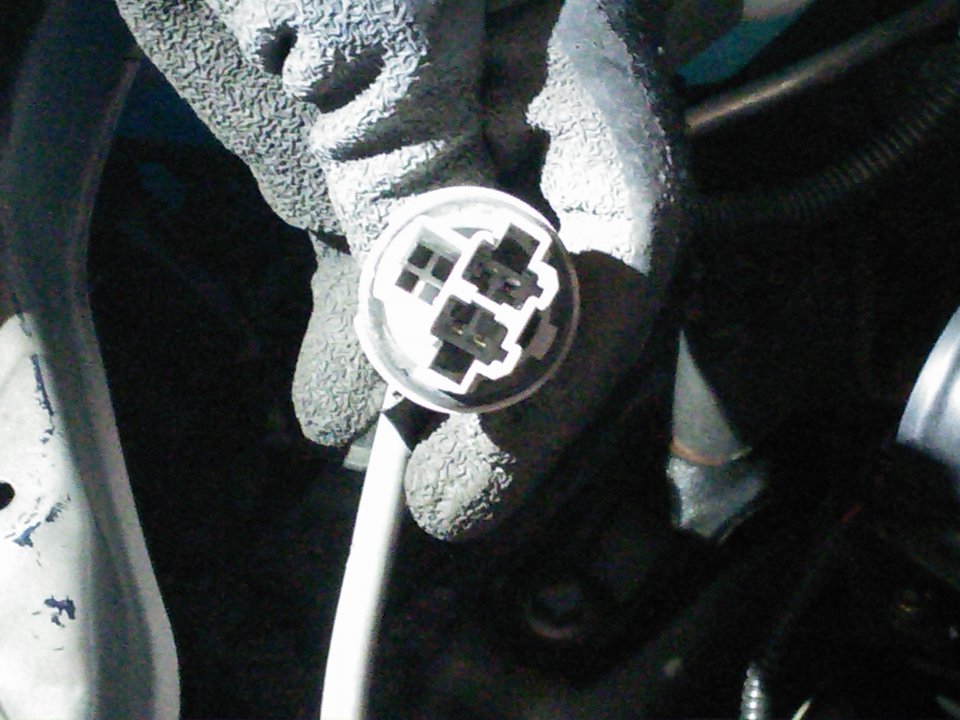

Found a disconnected plug, not sure what it is

    Found this near the front passenger headlight. Any idea what it is

    block heater?

    Not sure, I believe the previous owner put in aftermarket HIDs so that might be the factory harness assuming it is hard wired, I cant quite tell. THe block heater only heats the engine right? I ask because I am not getting any hot air in the cabin.

    yes, if you plug it in, it keeps the block warm so when you start it, it's somewhere above ambient temp.

    ever figure out the plug?

    haha, no I didn't. It's a little further down my list right now. I'll post once I get to it
