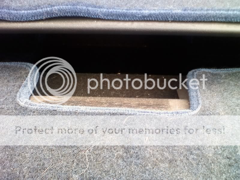

    On question 4, this has been figured out. The reflection is off the dipping flat surface in front of the speedometer cluster. You can squelch it by placing a vertical piece in front of the spedometer cluster. It should not be so tall as to block vision of the cluster. Its there to prevent light coming out of the cluster from reflection off the dipping portion, and then up to the wind shield, periscope style. I used 1/2 by 3/4 inch by 6 inch piece of black polyurethane foam about 1/4 the eay down the dipping flat section. I glued to the dash with double stick tape. This was foam from a discarded piece of foam floor mat. I used the soft foam so in case it came loose it would not be a hazard.

    I had the same problem and solved it basically like you described, although I used a thin piece of wood as it won't sag after a time.
