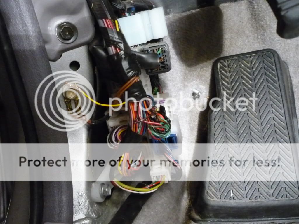

    As far as the DRL'S, I opened up the drivers kick panel and there is a white plug with bundle wires. On an online search I was given bad advice on what wire to snip.... I cut a Black/Yellow wire as advised, but the DRL's stayed on. (anyone know what that black/yellow wire is for?) Hasn't affected anything I know of.
    In that bundle, if anyone on this forum can tell me what wire to cut, I would be very appreciative.

    OK Just got offline with a Prius tech that was suprised this did not work:
    Grounded the Yellow/Black wire to Ground lug as shown.
    Prius tech said to remove Y/B wire from harness and ground to car, and this should do the trick.
    However after doing this no change. DRL's still work.
    Anybody on this forum advise me on what I'm missing to disable the DRL's.
    I would be most appreciative.
