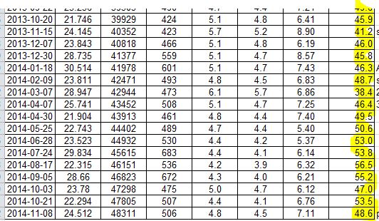

    Our numbers jump around a lot. Here's a bit over a year, calculated mpg in right end (highlighted column). I think you can toss out that 38, maybe some screw up at the pump. I'd like to throw it out, lol. Not really that much difference through the winter. Our winters are pretty mild tho.
