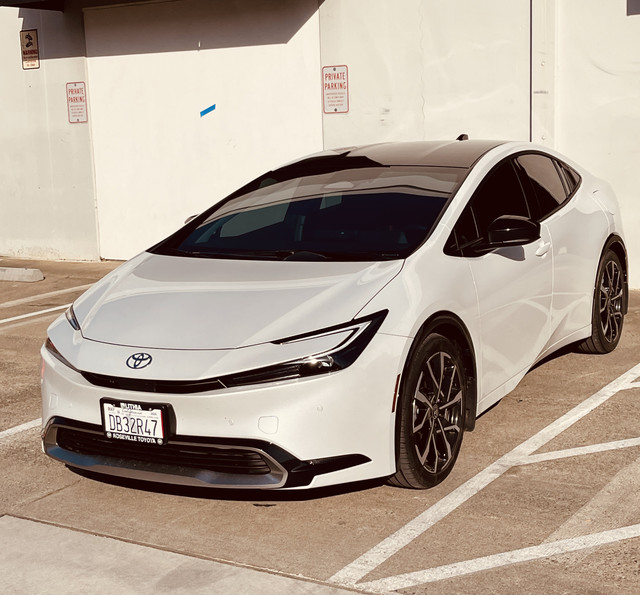

  16. Chi_weezy
    Chi_weezy Junior Member
    Feb 11, 2024
    35
    18
    Sacramento
    2024 Prius Prime
    Thought I’d post some pics. She’s coming along. Ceramic tint 35% all around + windshield and gloss black 3M roof and fin wrap. Black wheels coming soon
    RollingPanda, samsheldon and KenGenV like this.

  18. Chi_weezy
    Feb 11, 2024
    35
    18
    Sacramento
    2024 Prius Prime
  19. Chi_weezy
    Feb 11, 2024
    35
    18
    Sacramento
    2024 Prius Prime
  20. Chi_weezy
    Feb 11, 2024
    35
    18
    Sacramento
    2024 Prius Prime
    Debadged “prime” and the little circle. Considering debadging “prius”. And will blackout front chrome Toyota emblem
