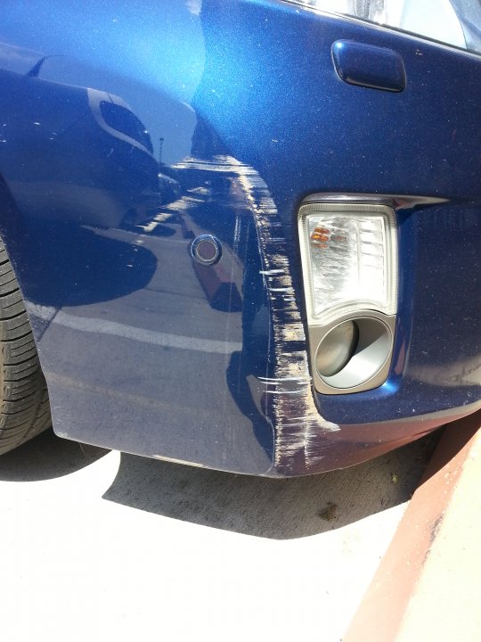

    So I scratched the front bumper of my 2010 Prius (right side) trying to back out of my parent's awkwardly placed garage... hopefully I won't make that mistake again.
    Anyways, I was wondering:
    • Could I just get it repainted? If so how much for that?
    • If I need to get the whole front bumper cover replaced, how much would that cost? (Parts & Labor)
    • If I don't get it fixed, aside from it looking ugly, is there anything wrong with driving the car like this?
    Thanks for your replies!

    Can't really tell from that angle until you get all of the paint cleaned up.
    Get some Meguiar's Scratch-X or similar and put some time and elbow grease into it.
    It may not look so bad afterward.
    If there's no 'dent', there are guys who go to dealerships and can fill and touch up scratches.
    All of this is based on your own tolerance.
    If it has to look like new, a body shop will have to remove and refinish the whole thing.
    May need filler on that edge, or you may need to get a new bumper.
    Last prices that I'd gotten were from $600-1000 a year or so back for a complete refinish/repaint in Blizzard Pearl.
    First, clean it up best as you can, then evaluate it yourself, and take it to a few body shops for estimates/courses of action.
    Could also hit eBay. Might get one in good condition, and even the right color.

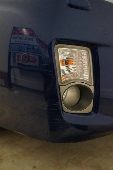

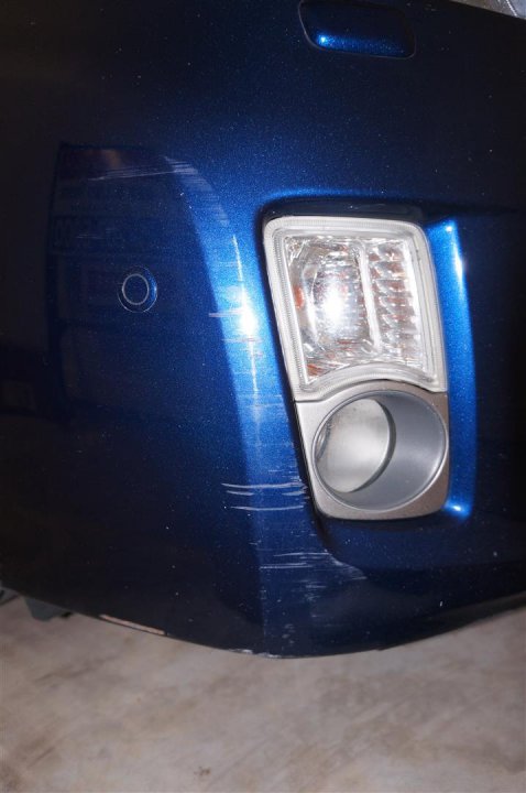

    I cleaned it off a little bit with water & a terry cloth... the nu finish my brother had in the garage was all dry so I will have to buy a new bottle.
    (One without flash, one with. Nighttime now so lighting conditions not the same in the garage
    It looks a lot better than before. I think some of it will need to be repainted, though I may be able to do it myself. I know I can't get it to factory-level, but that's ok. Thoughts? What should be my next steps? Kind of new to this kind of stuff.

    From the images it looks through the paint, not just in the clearcoat so I'm not sure the Scratch-X stuff will help.
    There is some euro stuff that melts and blends the OEM paint. I forget the name (Flix, or something like that). Also, Dr.Colorchip helps to fill the scratch then comes with a method to blend it in a little. It won't look perfect, but better.
