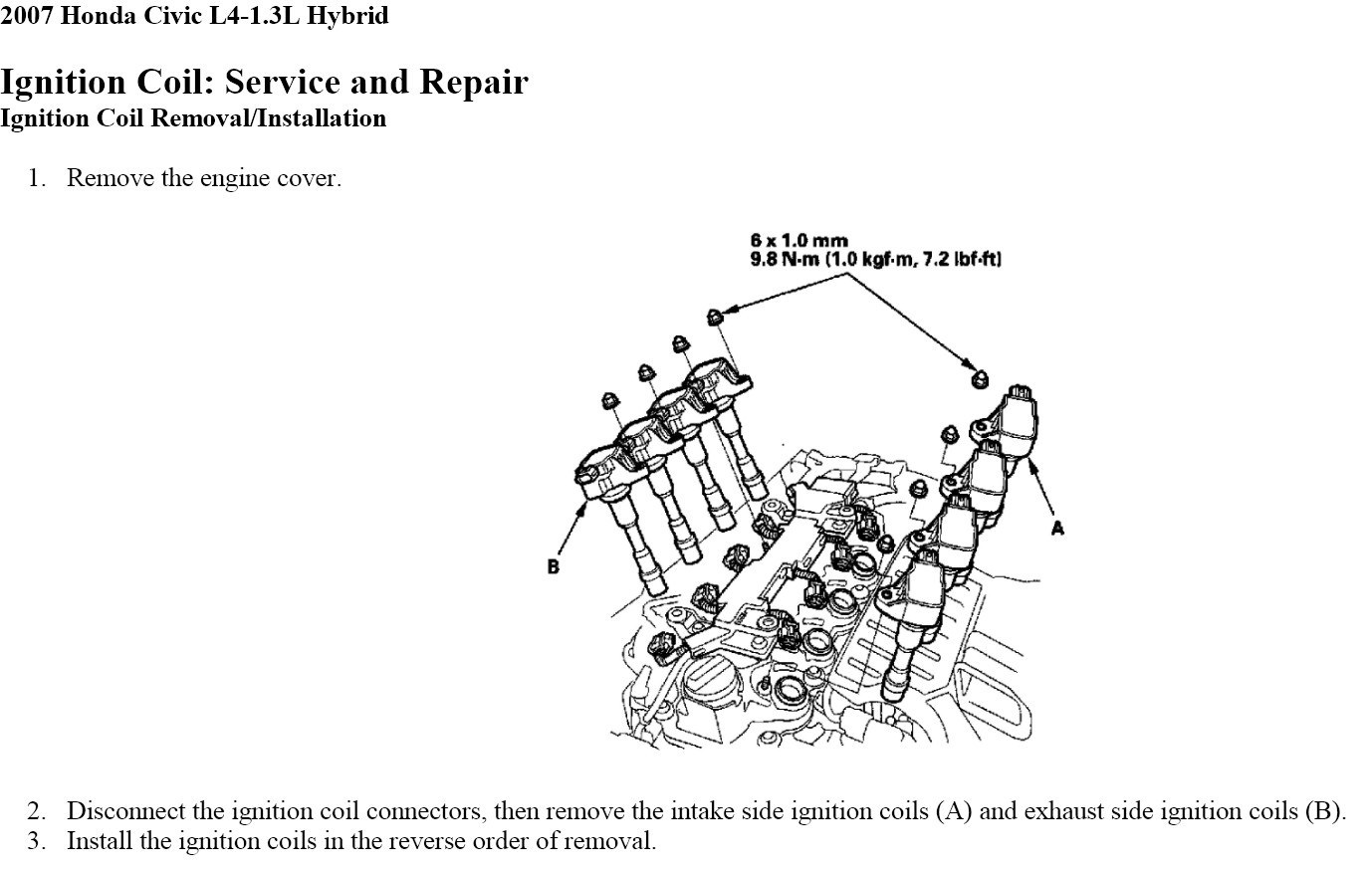

    Both the Civic and Insight (G2) hybrids have dual plugs. This sounds like the same concept, but merged into one plug? Whenever they say "2% more efficiency" they are comparing to a standard car with no improvements. If placed into an already-efficient car like the Prius, it might only be 0.01% measurable improvement. :)

    Interesting, I looked it up and looks like they have 2 spark plugs per cylinder. Not sure why.

    They ignite in a staggered pattern, controlled by the computer, for a more efficient explosion.
    Just changed the plugs on our previous '06 Civic Hybrid, at 160000~ km, it's now with our son.

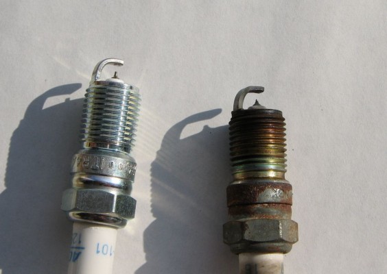

    The Delco iridium tipped spark plugs I put in my Buick has dual tips.

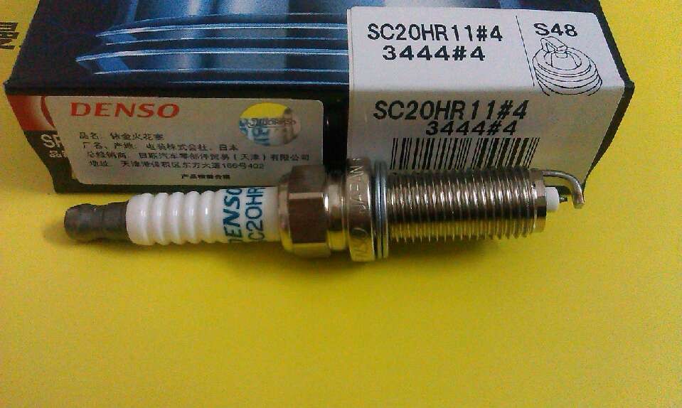

    Did they look like this?
    These are the OEM Denso Super Ignition Plugs from my RAV4. Long life "needle to needle" Iridium Spark Plug.
    This is the plug that the TT is a cheaper copy. Unfortunately the original SIP design is not available for prius yet.

    Close to the one on the right in post #3.

    Your post got me interested, I invested some time in google search and apparently the AC Delco Professional iridium doesn't have platinum wire ground electrode like you said. It just has a small platinum disc/plate (not wire), just like other double platinum or long life iridium plugs. Furthermore, it's made for AC Delko by NGK, so it's a re-branded laser iridium plug. Maybe you are talking about OEM plug? Possibly a re-brended Denso plug?

    No, I didn't say they have a platinum ground wire. There's no pic in your post #11, so I looked up the Denso Super Ignition plugs. They didn't look like the drawing, so that's why I said the Delcos were close to your drawing in post #3. In other words, not just a plain ground, but a disc of platinum across from an iridium center electrode. I couldn't get the platinums any more, so I stuck the iridiums in the Buick.

    Sorry the picture of my Denso SIP didn't show up. Here it is again:
    The drawing in the post #3 was from Denso TT, a cheaper version of SIP. The fine wire is less fine, 1.1 mm vs 0.55/0.7 mm for SIP. Here is how Denso TT looks:
    What's confusing, Denso TT in USA is platinum/titanium while overseas is nickel/nickel.
    Either way, none of those "needle to needle" advanced plugs are available for the gen 3 Prius.
