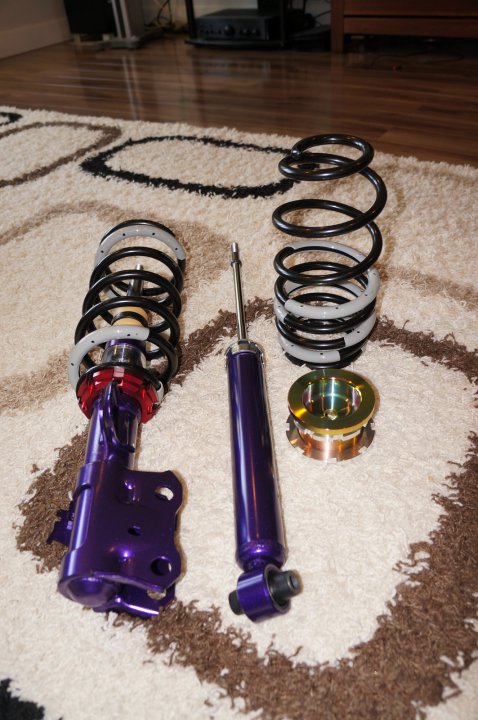

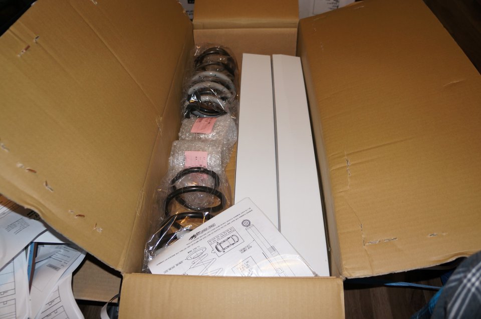

    In true Japanese fashion, everything was carefully packed and free of grease / dirt. There are English instructions provided but they are not the clearest. Also, there is a chart in the instructions with guidelines on ride actual height vs. perch height. This is great as it lets you set the height on the perches before installing everything onto the car. Otherwise, you'll have to do a trial and error with screwing around the perches, putting the wheels back on for a short drive, and then parking the car, jacking it up, removing the wheels and then repeating all the steps above to get the perfect ride height.
    The front adjustable sleeves are anodized red but the rear sleeves are just aluminum colored. I wonder why not just leave everything aluminum or everything red - it would have looked more consistent that way. No big deal. Just a heads up that when you use the spanner wrenches to adjust the front coilover, the red anodized perches' paint will chip off easily.

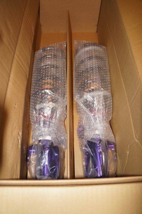

    Strange color scheme for the suspension: I noticed their strut bars are red, the chasses stiffeners are bright red and then here we have purple shocks. But then again, no one really gets to see them except your mechanic when you bring the car in for servicing! Notice the springs are wrapped in a grey sheathing on some parts? Apparently, these are supposed to prevent "clunking" noises which are common with coilovers (more about this issue later).

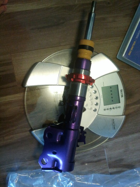

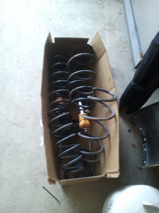

    Being the geek I am, I weighed all old parts vs. new parts. Old parts are 49lbs, new parts are 46.8 lbs. Another point added for weight savings!

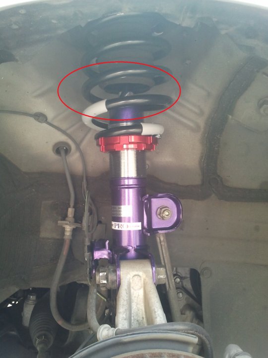

    The instructions recommend to trim the oem front rubber shock boot when reinstalling. The dust boot prevents dirt from getting into the seals and piston of the shocks. From this picture, it looks like the shop that did my installation may have cut off too much from the boot. However, when the car is set down on the ground, the shock boot covers the piston and overlaps the shock body just enough to provide some protection. Just a warning to others to be carefull when trimming the shock boot. Cutting too little is better than cutting too much.

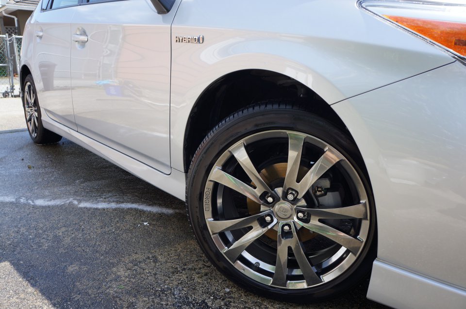

    Sept 30, 2013 - This is the car the day I picked it up from the Toyota dealership. Oem springs with 4x4 ride height:
    This is another shot before lowering. Floaty suspension and huge wheel gap = not cool
    Here is the car w/1 inch lowering all around. Not too low so I don't have to worry about speed bumps.
    I am going to have to give credit to my Sony NEX camera for these great night shots. I'd never be able to do this with a point and shoot camera.
    Conservative 1 inch lowering but looks great with the sport package Prius. It has a more aggressive and ground hugging stance.
