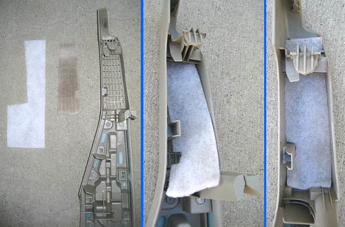

    Here's a cell phone pic the mechanic took of the clogged squirrel fan:[​IMG]
    After everything was cleaned out, I wanted to prevent this from happening again. Gordon suggested heater vent filter: these are used on the floor vents in houses to prevent dust from being blown out when the heater goes on. Since this is also a low air-flow situation, I hoped it would work to prevent dirt and fur from entering the compartment, yet still draw air in.
    We made a paper pattern and cut out the vent filter. Removing the fan cover was easy (one bolt) and the filter was easily placed inside the cover (save the little square of filter material-- you'll see where it goes when you put the filter in).
    Hopefully this will be helpful for the two other Prius drivers who have four-legged passengers and enjoy open windows! Be sure to check your battery compartment! This was a $700 fix!
    Outcome? Not sure yet...I will check the compartment in a month or two and see what it looks like. But I checked when the fan turned on and there was air flow into the compartment and my mileage increased by 4-6 MPG and my engine now shuts down at all stops. Car and I are much happier now!
    Edit: here are the install photos:
    Removing the filter cover: you need to pull the bottom seat cushion out a bit to get to the single bolt holding the battery fan cover down. The bolt is probably metric, but a 1/2" crescent worked. The black hole in the center is the vent leading to the battery compartment. Last photo is fan cover replaced with filter inside.
    Installing the filter: After you cut out the filter material (see above), you just slide it into the area behind the fan opening. I didn't use any adhesive-- the pressure of the closed fan cover holds it in place.
    After one month, the filter was this dirty, so I guess it's working!
    Full size pics in this Flickr set:
    Prius Fan Problem - a set on Flickr

    If we had an MFD temperature indication for the batteries something like this would be a lot easier to diagnose...if we know the battery is getting hot then finding the cause becomes a lot simpler.

    A filter on the battery vent looks like a good idea, though it shouldn't impede the airflow much. Short of shaving the dogs, I'd recommend checking the air cabin filter at least once a week. I'm pretty sure I don't want to see pictures, but you might check if it's time for a new bag in the vacuum. ;)
