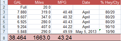

    This isn't my first hybrid. I bought a Honda Civic Hybrid at the end of 2005. I had it for two years. Gas mileage was consistantly 40-41 MPG The last 4-5 months I had it, it started having major mechanical issues. I took it in to the dealer 6-8 times and had many heated discussions with them. They were never able to fix it and I ended up trading it for a Nissan.
    Ok, fast forward to 2013... I decided to try the Hybrid route again. last month I purchased a 2013 Pruis (Gen III). I'm on my 5th tank of gas and I'm pretty disappointed in the MPG. The first 4 tanks I got less than 41 MPG. As I said this isn't my first hybrid but just in case anything has changed I've viewed a number of videos on "getting the best mileage and *think* I'm doing the right things.
    The tire pressure is 40 PSI all around and the oil is at the full mark on the dip stick. I live in Houston so the weather has been in the mid 70s to mid 80s except for a couple days when it dropped to the
    low 40s over night. I do use the "B" mode on the shifter when I see trafic slowing and go back to "D" for normal driving and I also try to space out my breaking so I get maximum power regeneration during stops. I do all my driving in ECO mode (the green ECO mode indicator on the display is on).
    I've had the car a month. I've taken two short trips, one from Spring, TX to Dallas and back and one from Spring to Austin and back. The rest of the miles were in town driving, all relatively flat areas.
    When I drive the car I've found out a few things that may or may not have anything to do with why my gas mileage seems to be low (at least to me).
    Here are my observations
    1. When I start out in the morning the battery indicator on the dash is always at half or one or two ticks above half.
    2. It's impossible to stay in electric mode until I've driven 6-10 miles. I can then use electric only but even then it's touchy at best.
    3. The battery indicator quite often goes one to two ticks below half. I guess I'd expect that but it does seem to
    4. spend a lot of time there. Once the ICE kicks in it will eventually go to 2 tick above half but doesn't seem to stay there long.
    5. The instantaneous MPG indicator is acting like I would expect it to act considering the gas mileage I'm getting. When I'm accelerating it goes to about 10 MPG and when I'm cruising along in electric mode it's at 100 MPG. If I'm cruising at 50-65 miles per hour the MPG indicator is always reading below the 50 MPG mark by a couple ticks. When cruising at other speeds the MPG indicator varies but is almost always below 50 MPG.
    6. Now there have been a few and by a few I mean 3 or 4 occasions where I've been cruising along at about 45 -50 miles per hour where the battery indicator went to 3 ticks above half and when this happened the instantaneous MPG was indicating about 60-70 MPG for a mile or two but as soon as I had to slow down or stop at a light it would go into it's old mode. The battery indicator drops to 2 ticks above half and the instantaneous MPG goes to crap again. Like I said I've only experienced this on a 3 to 4 occasions.
    7. Another thing I've noticed is that when I accelerate from a stop, even very slowly, the indicator that indicates "PWR" mode (the last inch of the indicator bar that turns red) goes into the red area. It's like the battery assist...ISN'T. Yes, the MPG jumps to 100 MPG for a split second when accelerating from a stop but then drops to 10 MPG and the bar goes into the red PWR section.
    I'm not saying anything above is a problem with the cars operation. The points are just my observations. But, why is my gas mileage so much worse than what most everyone else seems to be getting?
    Am I expecting too much to ask for better MPG from my Prius that from my Honda Hybrid?
    I haven't taken it back to the dealer yet. What do you guys think. Do I have a problem or is less than 41 MPG acceptable?

    May 5, 2013
    Spring, TX
    I don't have a "usual commute". Some days I don't leave home, other days I go various places. About the only places I go on a regular basis I take my other car and the Prius is left for my wife to go someplace if she wants.
    ok, I promise to never use "B" ever again for coming to a stop.:p Still not sure about not using eco mode or not and I see no value in PWR mode for normal driving. Although. I do miss the 436 HP of my other car at time when I'm in the Prius. :LOL:
    So, before I left on my 15 mile trip yesterday I reviewed Bob Nagy's video. I went from Spring to Galveston to Kehma and back with three 5 stops along the way. I took the scenic route with no freeway driving except for a couple mile crossing the bridge to Galveston and then about 40 miles of congested (5o-60MPH) freeway on the way back. I started the trip with about 140 miles on the current tank of gas and filled up when I got back so I could get a reading on my first tank of mostly city driving.
    As you can see the mileage for my trip was much better that my other tanks which were mostly highway driving. And for the first time I was able to "relate" to the information in the video. It acted exactly how I thought it should. Driving at highway speeds and short distances in the city was not giving me the feedback I thought I'd be getting. So, I guess everything is cool now if I can just figure out how to get the highway mileage up. Maybe I just have to go up the learning curve a little more. If you notice, line 6 in the graphic shows an increase in MPG. That is the tank where I switched from normal to ECO mode about a quarter way through the tank.
    Thanks for all your help. I still have a couple thoughts but I'm out of time here for now. I'll try a few more things from your suggestions and let you know how it goes.​
    Thanks again,​
    Gordon​
