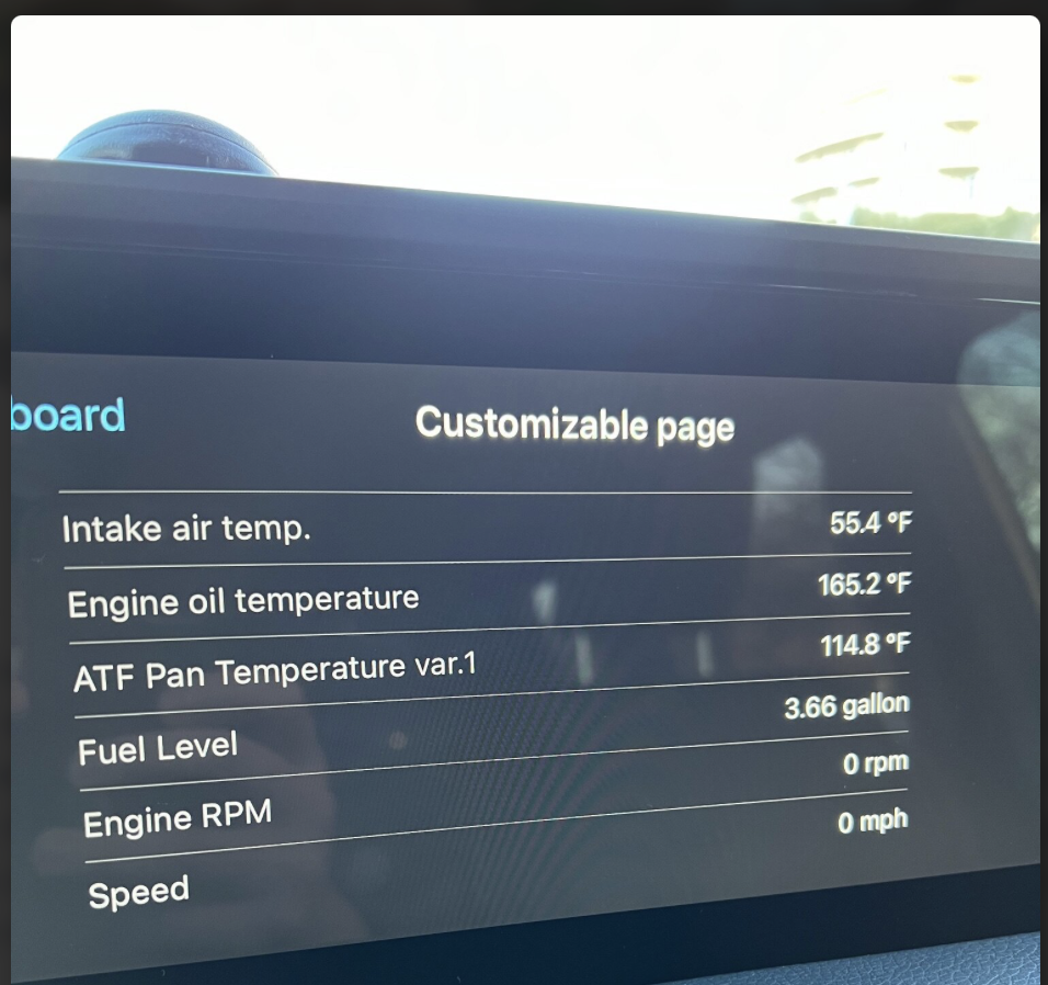

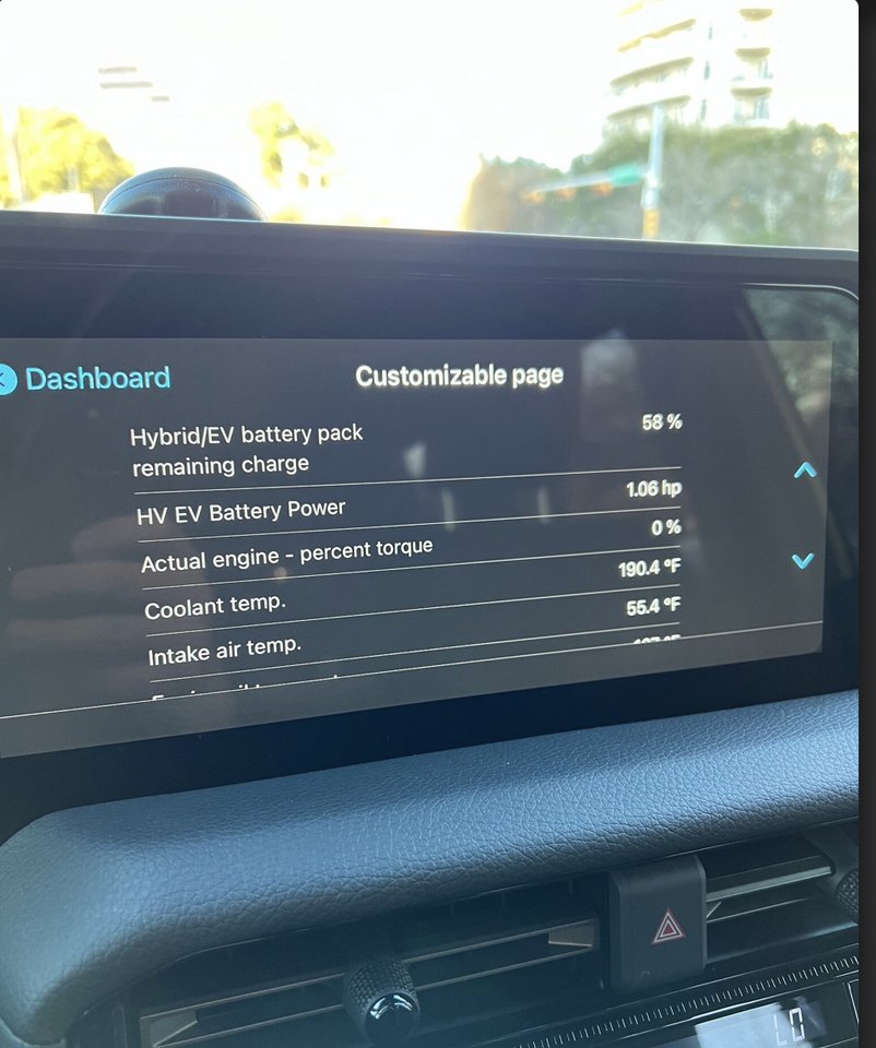

  7. VelvetFoot
    VelvetFoot Member
    Sep 17, 2025
    134
    32
    New York State
    2026 Prius
  8. VelvetFoot
    VelvetFoot Member
    Sep 17, 2025
    134
    32
    New York State
    2026 Prius
    OBD Fusion seems to support a lot of HV custom PIDs (I'm learning the lingo):

    Reading further into OBD Fusion, it seems that while it (and maybe all others?) can't display dashboards via CarPlay, it may be able to display a customizable list of PIDs.
    It's 10 bucks. My MINI doesn't do CarPlay, but I may try it.
    Perhaps I should do some more searching. lol.

    Bought app.
    Looks like my OBDLink LX101 doesn't work with phone/app.
    I sent a support request.
    Thinking I may have to upgrade dongle to MX series.
    Switched fairly recently to iPhone, so that could be part of it.
    edit: LX not compatible with iPhone.
    #11 VelvetFoot, Oct 2, 2025 at 9:47 AM
  12. VelvetFoot
    VelvetFoot Member
    Sep 17, 2025
    134
    32
    New York State
    2026 Prius
    edit 2: Ordered MX+
