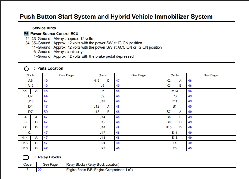

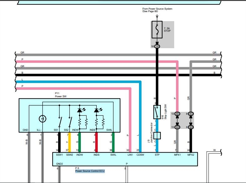

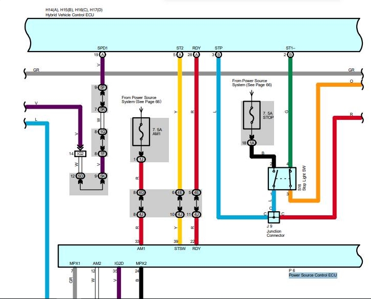

    Reading through a wiring diagram document and I see that:
    This might be that PWM switch yellow line (pg 96 of 390): PowerSourceControl_PSC_ECU_1of2_postPC.jpg
    This might be the spliced and tapped switch yellow line (pg 224 of 390):
    Does that seem correct?

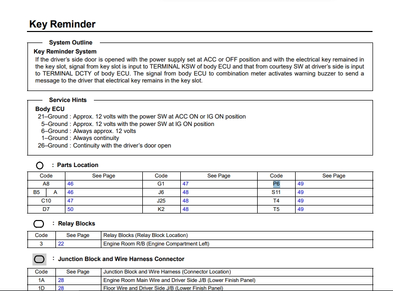

    Also, I don't recall the Buzzer with the door open and Fob in the slot. Though the Dash Combo Meter showed the door open and Fob in the slot. I don't recall in Techstream an option where this buzzer can be turned off.

    My buzzer is removed by me already. By reading the post you highlighted way back the connections seem easy at the big white pwr dust block and next to it . The poster does a pretty good job describing the connections. And I would think the just mis connected a connection that isn't . Not hanging but not making connection mylar on the wires something...

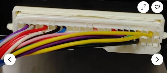

    Which plug is this ? You know what pwr distro box is under dash right behind your hand when they're at ten and two on the steering wheel behind plastics . Fat white wires something that looks like it'll carry a load. The guy in that old post is talking connections in that area .kinda like working on CM monitor. But not always undone.iveva car opened up 8 can send pic
  12. James Analytic
    Jun 14, 2019
    331
    52
    Michigan
    That plug above in the photo is off ebay regarding the PSC ECU as I was reviewing that connection that in my mind might be a potential situation for the install. I wanted to be better able to visualize what I might be getting into. Was I way off once I removed the two vents and trim piece above and below the steering wheel and paying attention way more with plenty of daylight.

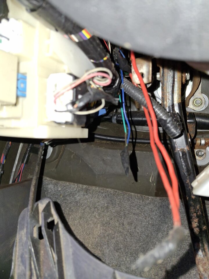

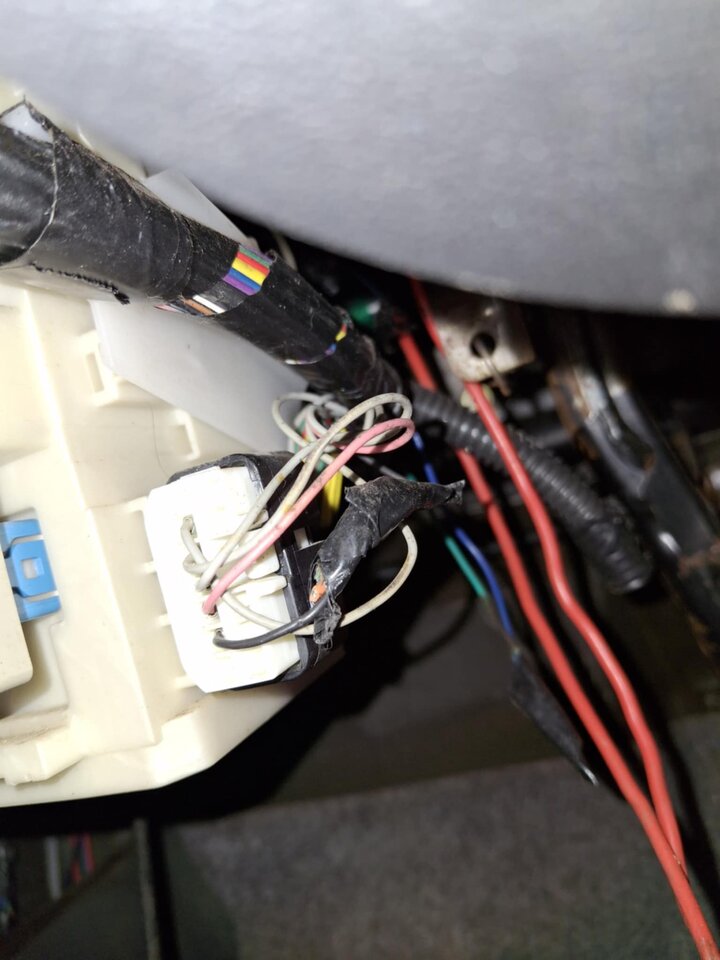

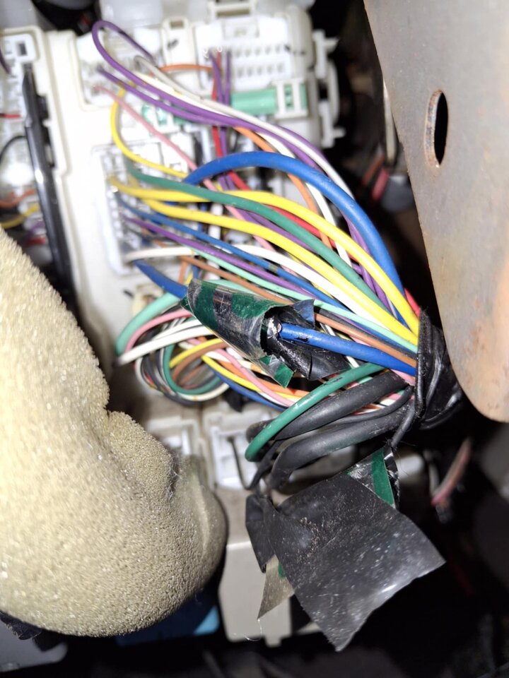

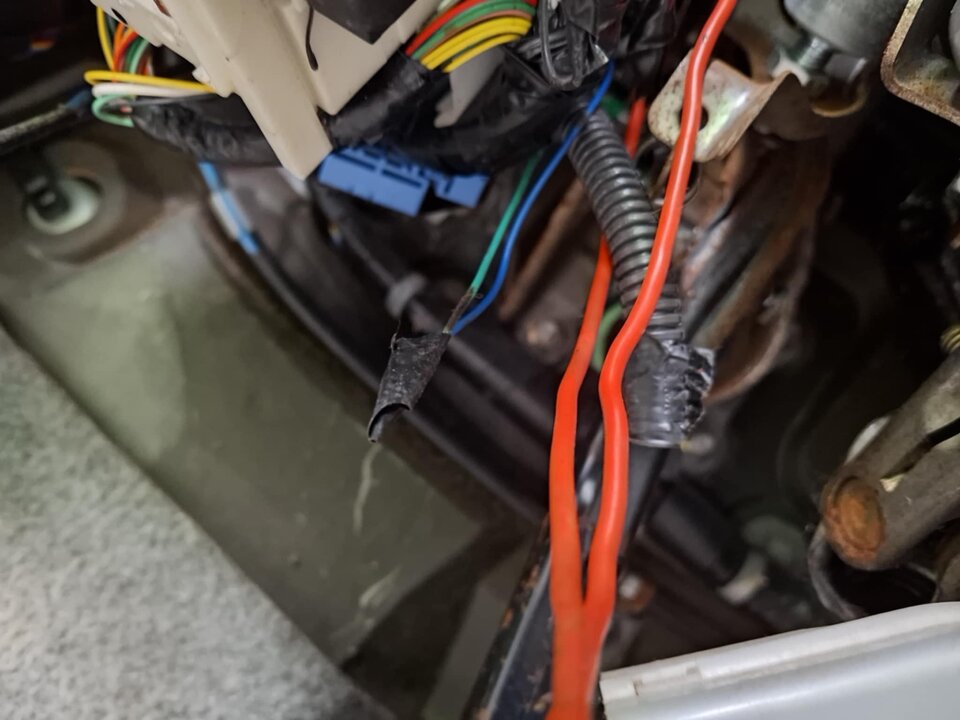

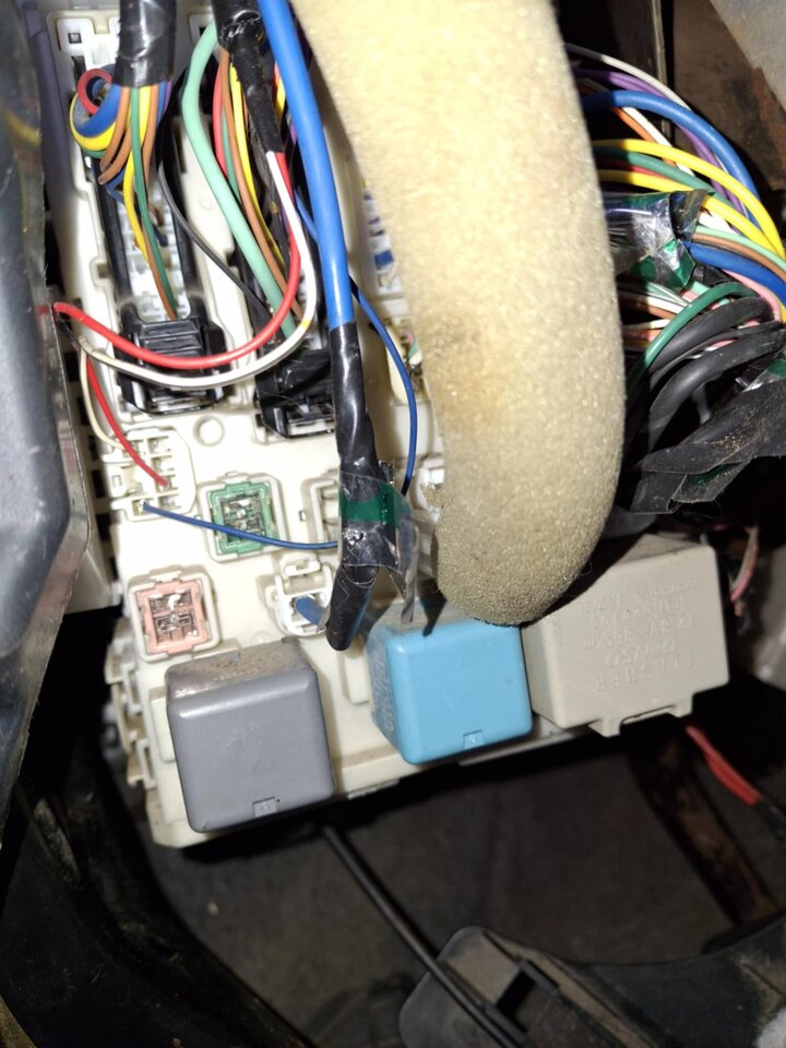

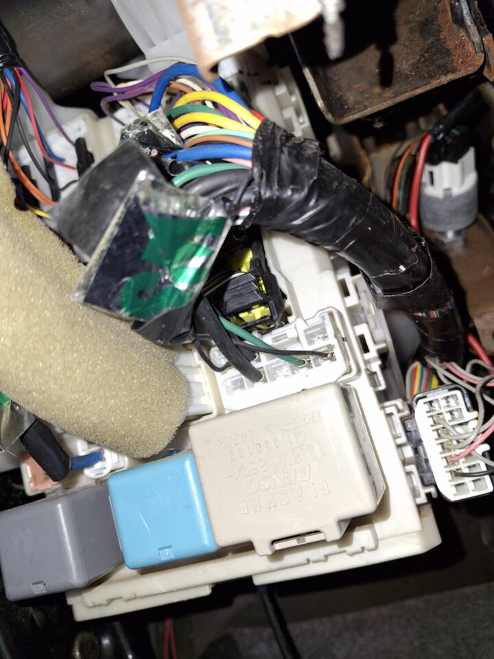

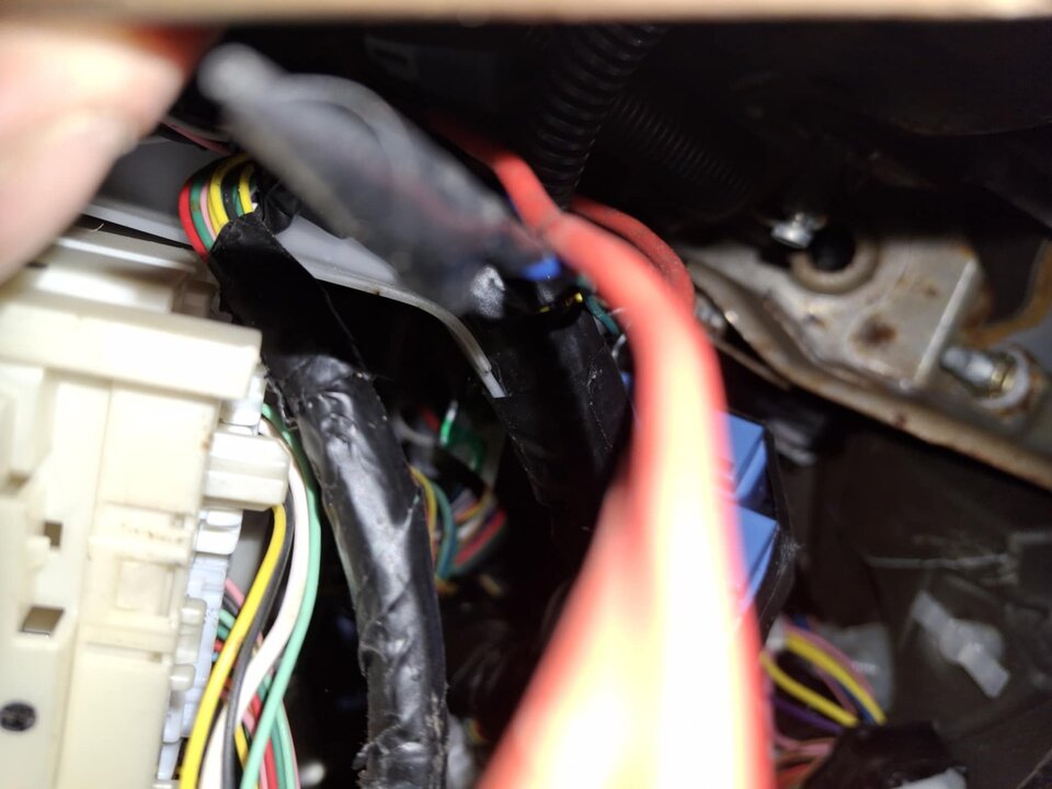

    Just got back and realized all the connections were made like you said from the power distro fuse box, a.k.a. Drivers Side Junction Box. I actually was about to start removing the Dash top panel piece to get at the PSC ECU and realized most likely might be better to remove all 18 connectors to the Drivers Side Junction Box and see what's the situation and if all cuts were done there to return to stock wiring that ways. Appears was done that way already with only one of the bolts of the three present and that metal cover missing.
    Observing what I can see and document today for the hour or two I spent there, cleaning mainly and draining the swamp in the back behind the wheel wells. The most concerning is the green and blue wire along with what I can't see behind that box as looks like a mylar there as well up behind. What are those and what are those green and blue genuine stock supposed to be doing, that don't look right? 5d17a1ef-627d-4cf6-8096-511a9b7243a3.jpeg 9bef9f3b-31b2-48c6-8d17-abe10c5a679a.jpeg
    There's something shiny mylar up behind the Drivers Side Junction Box, so really once I saw this I had decided remove that Box is the next chore when I find the time.
    d84c40d9-1c7a-4bec-816f-de9524672bf8.jpeg 10f0a835-5174-41a3-85f6-d0ed8ea2b16f.jpeg b3c7627e-f48f-46e2-a607-7cea3f2e2f48.jpeg da653d3d-2b21-48a1-b9ad-a386340ddffb.jpeg d2388cba-dce7-41a5-85fd-e6beb6346ee5.jpeg
    Good thing is there isn't a Brake situation, as I checked all the functions and ABS Actuator-Accumulator pumps can be heard when brake pedal is pressed and all the lights work from what I could see. Just no Buzzer or response with the Power button or in general when the Power Button is pressed. Just doesn't do anything to get into the ACC ON, IG ON or HYBRID STARTUP (READY) Operations.
    Seems the smartkey functions are not working as well, so fob needs to be inserted. I did confirm the door locks work at least.
    I did replace the 15A PW OUTLET FR that wasn't present, though really doesn't have anything to do with as I think that is the Cigarette outlets? Tested all the other fuses and they tested good.

    So this blue and green wire is down in the driver kick panel next to foot rest . I've a car with all this open rt now I'm pulling engine as we speak with my new hitch mounted hoist blessing
  14. Tombukt2
    Tombukt2 Senior Member
    Nov 29, 2020
    12,988
    2,328
    Durham NC
    Can you follow that blue green wire set to somewhere?

    Yes, planning to go back and pull that Drivers Side Junction Box (Driver Side J/B). Then just assess and guessing most likely reconnect all the wires.

    I'm going to check literally the wiring harness related to these suspected areas first and possibly relays once I get everything looking better. Wiring job looks bad IMO. Western Splice with solder and dielectric grease shrink wrap is my prefered in vehicles, at least outside and why not by the floorboard.

    Yeah I'm waiting to hear what these blue and green wires that are just sitting there taped up and looking crap spliced and whatever is going on. Then connect all the colored wires back to each other as new then see if it does all sposed to . Then clean it all up how ya like and it'd be over .
  19. Tombukt2
    Nov 29, 2020
    12,988
    2,328
    Durham NC
    Looks like someone just left undone connections
