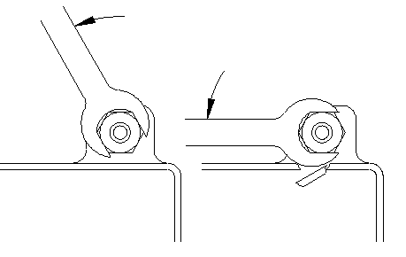

    Oh and the best time to replace the pcv valve is with the V cover off.
    It's easy to break the case with a wrench with a cover on. Deep socket only no box wrench. many posts about broken cover.
