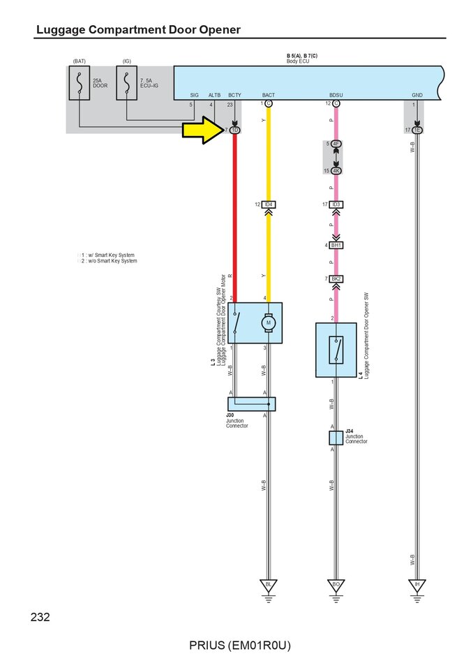

    I got my hands on the the wiring diagram for the car took a look at the hatch area. I noticed there were no fuses between my splice point and the body ECU, which leads me to believe I damaged the ECU. I tested all the electronic components in the hatch, from the hatch release motor to the lights, and everything appeared functional. I ordered a replacement body ECU so I'm hoping that fixes the issue.

    1. Have disconnected the nonsense
    2. I needed 12v for the camera that would turn on when the car turned on and I deleted the rear wiper motor so it made sense. But moving forward I'm definitely going to just do accessories right with a relay, fusible links, and a distribution block that takes power straight from the battery. This was particular job was admittedly very poorly done by my standards.
    3. This is where I spliced:
    Link -
    This is what it would look like on the wiring diagram
    Link -
    Like I said earlier, both the relevant fuses were not blown. After looking at the schematics, I wonder if the J34 module is damaged. Here is everything that doesn't work on my car:
    Link -
    But its just a junction connection, I don't really see how that would cause my issues unless I accidentally unplugged it while I was working. Even then, that wouldn't explain the weirdness on the dash while shorting and the fact that I was getting power before I shorted and not after.
    Here's another image of the diagram
    Link -
    All roads seem to lead to the body ECU so I think I might've damaged that as well. I'll check the junction connection tomorrow and report back.

    I couldn't wait and I went to check on the J34 plug and found it was unplugged. I plugged it back in and only my middle brake light came back on. Everything else on the hatch did not work. I'll have to look into it tomorrow.

    Yeah, in everything you posted, I wasn't seeing any roads leading to the body ECU. I hope you find some equally simple explanation for what's still out.

    Update - It was the relay between the luggage compartment courtesy switch (the switch that tells if your hatch is all the way closed or not) and the body ECU. Replaced it and now I have full functionality back.

    o_O What relay? The diagram you posted shows none. Can you post a pic of the 'relay' you replaced?
