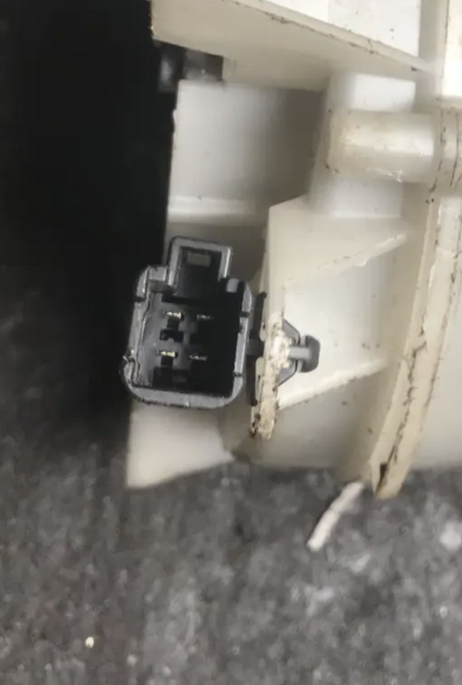

  8. vjekobalas
    vjekobalas Junior Member
    Aug 18, 2021
    36
    Croatia
    I have the attached blower motor in a 2013 European Yaris - connector S14 on the battery cooling blower assembly (with male terminals) wires are same color at following pins (1=red, 2= white, 3=blue, 4= black) - does anyone know whether the pinout is the same ?

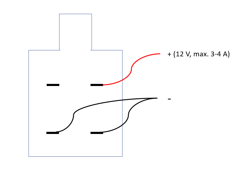

    For connecting on the bench just using a power supply or 12 V-battery it is simple:
  14. Shadyghabboun
    Shadyghabboun New Member
    Jun 16, 2022
    Amman
    2015 Prius c
    Thank you for your prompt reply ,
    i did the wiring in the schematic however the fan starts and stops, and does not keep running, any idea why its doing this strange behavior?
  15. priusb78
    priusb78 Member
    Jul 20, 2009
    52
    46
    Nuremberg, Germany
    That's strange! What do you use as power supply?

    To run my Gen 3 fan on the bench (for battery charging) I use a power supply where I can set voltange and current. With 12 - 14 Volts and 1 - 3 Amps the fan runs well.
