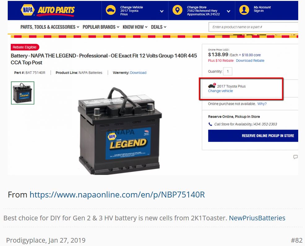

    If you want to (are willing to) go aftermarket, you might consider this option:[​IMG]
    It's a Group 140R size, not the most common out there, but findable. Is fitted in cars like the Chevy Spark, etc. IIRC.
    But note: there's a consistent anomaly in the parts finder databases the online sellers all use. It will NOT show any Group 140R as being a match for the Gen-4 Prius, even though dimensionally and by performance parameters, it is essentially an exact match.
    Just something to consider. Even if Toyota won't "outsource" and buy you one for wty replacement, spending the $138 might be worth it just to get your own car back. . . Good luck with it.

    But it's not an AGM battery that TOYOTA uses.

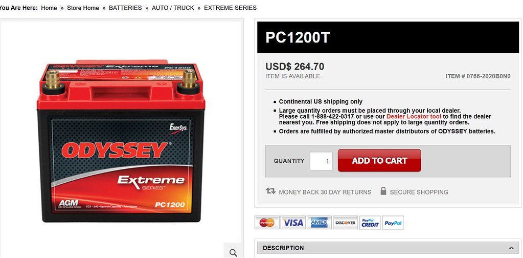

    Technically, yes. That said, I'm considering an Odyssey PC1200T. It is AGM. It's slightly smaller in all three dimensions than the OEM 12v. It exceeds or outperforms the OEM in all performance parameters. It DOES NOT have the extended "lip" at the base that engages with the Prius battery tray. I'm looking at strap or bracket options, or using epoxy to fashion my own extended base so it will fit properly. And yes, it's a tad bit more expensive than the NAPA lead acid option, but seems competitive with dealer price options. [​IMG]

    Has your battery failed already? I'd have thought that the warranty would be current on your OEM one.

    No, mine's still "good" -- for now, but I'm keeping a close eye on it. The "problem" is that my Scangauge most often reports voltages from 11.6 - 11.9 if I power up to the Accessory or ON modes (versus READY mode). In a conventional car, this would be a strong indicator that the 12v batt was on its way out. But of course, with cranking loads never challenging the battery, who knows. . . I am seeing no other indications of trouble. I'm just doing my homework in advance so that if I need to act, I'll be prepared. As for the wty, I really haven't decided whether to go that route, or just bite the bullet and get a top quality AGM at my own expense. I'm really not interested in playing the "serial replacements" game with a 12v design that appears to be somewhat troubled in this application. Also, frankly, I just enjoy "overkilling" things with my machines -- especially my car. I mean, I own a Prius fer cryin' out loud -- that's a tad bit extreme in and of itself! ;) :cool:
    EDIT: you may recall from earlier discussion that my car was a dealership "orphan" that sat for a year, dealer swapped twice before I bought it. Perhaps not surprisingly, it already had a replacement 12v instead of the factory battery. I have zero knowledge of the circumstances or timing of the replacement. The car had exactly 100 miles on the ODO when I took delivery.
