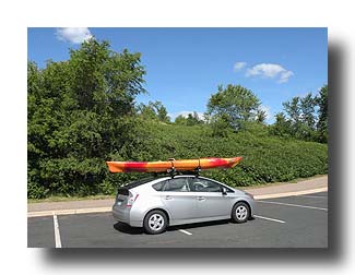

    Lots of photos here and here using my Yakima rack, over the moonroof.

    CAN you still open the sun roof with the rack on the car:confused:

    Yes, but then you'll never be able to shut it ever again. :crutch:
    The rack itself sits on the metal, so it all fits nicely. But the glass would make damaging contact if you attempted to open the roof.

    Thanks for those pics john1701a!
    I've been saving for my Prius and had become very interested in kayaking in the interim, so much so that I considered not getting the Prius in favor of something a little more...rack-friendly. However, your pics just helped to reaffirm my love affair with the Prius and squash any fears I may have had about racking a kayak.
    So, thank you very much :)
