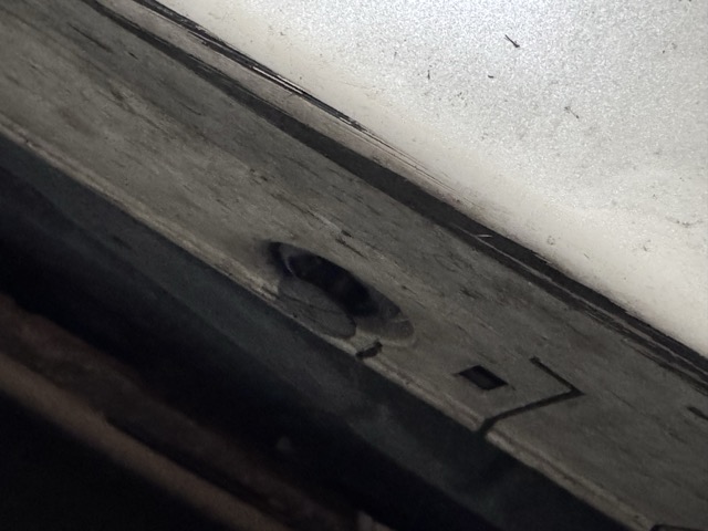

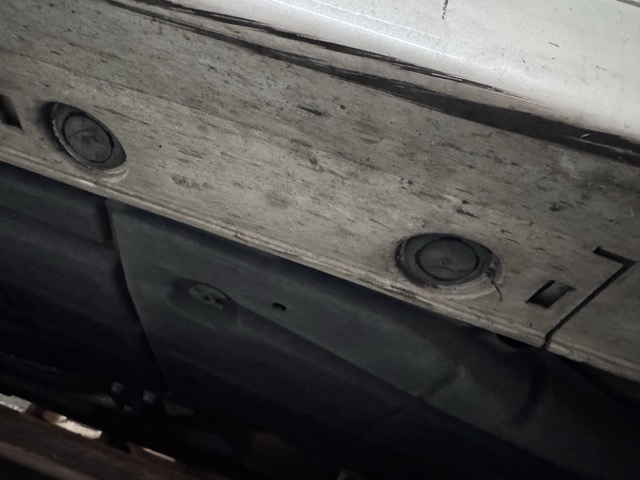

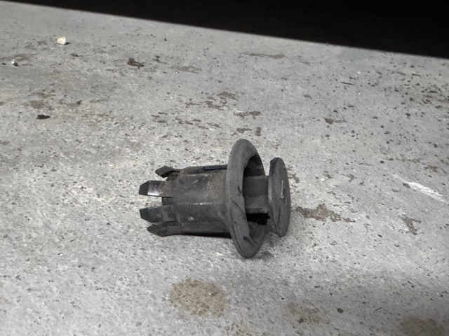

    4. Remove the Side Skirt
      • You can opt to remove only 2/3 of the side skirt and push the rest aside.
        1. The black clips holding these together are very large. I used my clip pry tool and a flat head screw driver on opposite ends to pry these clips out.
          side skirt flush Medium.jpeg side skirt popped Medium.jpeg side skirt clip Medium.jpeg

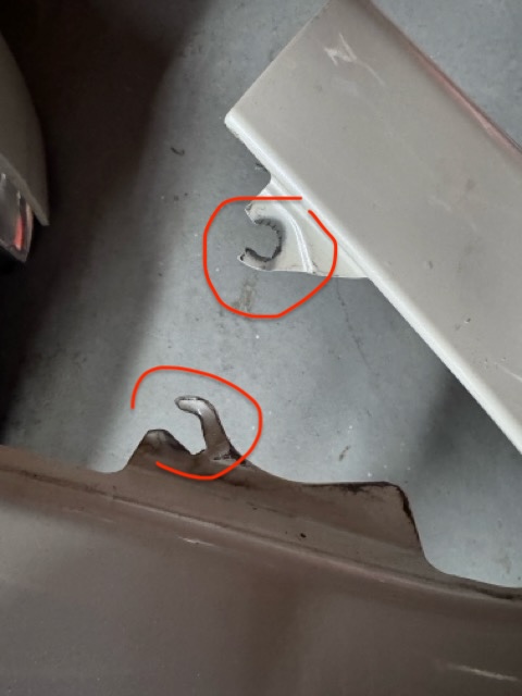

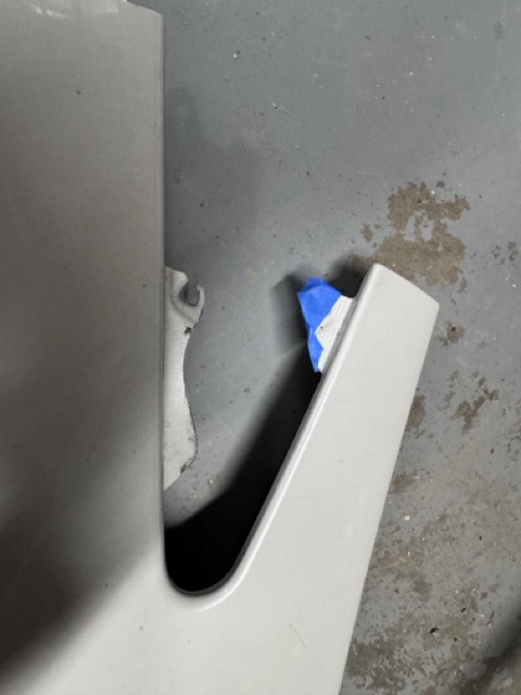

    The most challenging aspect of the fender replacement is achieving the correct fit around
    the triangular window. In my experience:
    • I had to cut some of the metal on the new fender to ensure it fit snugly underneath the triangular window. Without this, the window butted up against the fender and caused large gaps (approximately 4mm). I used a hacksaw to cut deeper and a metal file to shave down the rough edges
      I also put masking tape around rough metal edges that bump around the glass and plastic:
