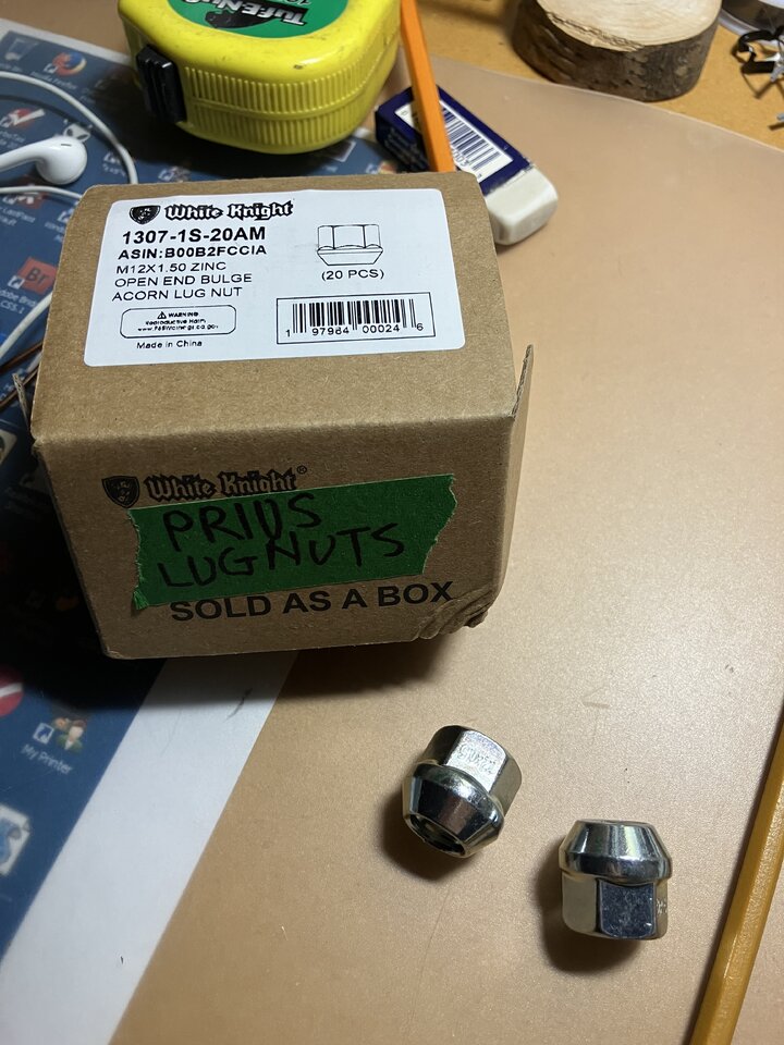

    Thank you Mendel. If I interpreted what you sent correctly, I need:
    • #42611-47641 17x6.5J Steel Wheel (Type C)
    • #90942-01131 Lug Nuts (Type B)
      AND
    • #90942-05009 Valve (Tubeless Tire)
      OR
    • #42607-47010 TPMS
    • #90942-05047 Valve (TPMS)
    I had seen these pages linked to other threads, but wasn't sure how to translate! <g>

    Regarding the lug nuts: Your car will already come with a set of the Type B. They're identical between the 17" and 19" wheels.
