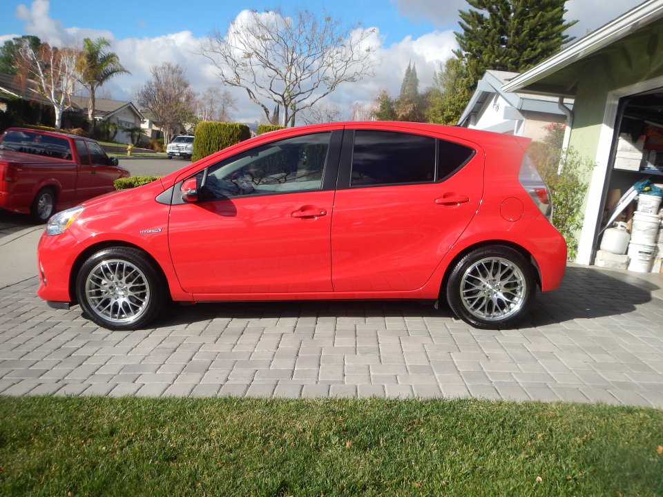

    Americas tire website has some wheels. that's where I got mine from. They also have them in black with a red stripe. They are Maxxim Maze 16x7 wheels on stock tires. DSCN0404.JPG

    Thanks for sharing wheels and pic of your Prius. They look nice on your ride. Did you keep the stock P175/65r15 Prius came with or did you increase the tire size? Also, how's the gas mileage with your new shoes (wheels)? I am tempted to see how they look on my blk prius. I didn't see machine blue stripe wheels for those. Do you know if that be special order?

    I bought my car with the 16 " OEM alloys which had 195-50- 16 tires. so I used the original tires on the new wheels which where about .5-1 inch wider. Fuel wise no problems. They also have them in black with a red stripe around the edge. Go to America's tire online, type your car info and look under MAXXIM MAZE and you will see what they have to offer for your car. I just checked it out and they have 15' wheels also. Yes they had to order them but got them in 2 days. Around $700 for everything. Just remount your stock tires if they are in good shape with tread and you are done. Hope this helps. Have a good day! God bless!
