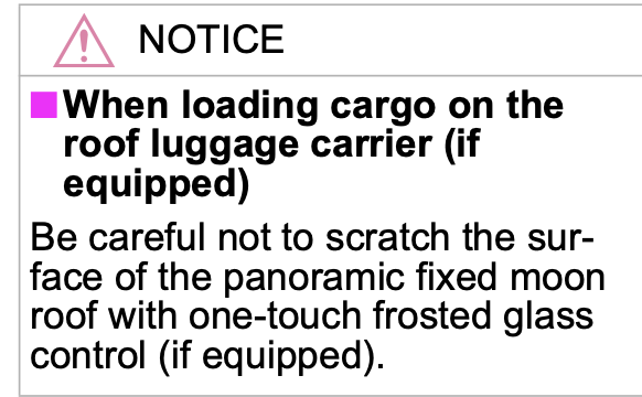

    This is the only reference I found in the manual to the moon roof. What is the optional one touch frosted glass, I wonder?

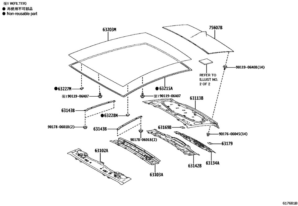

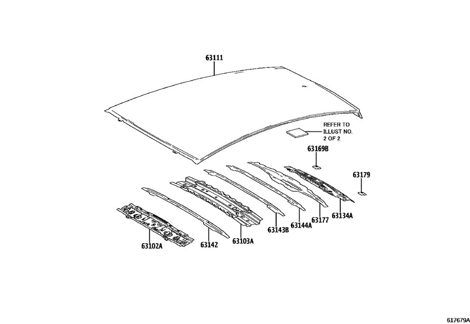

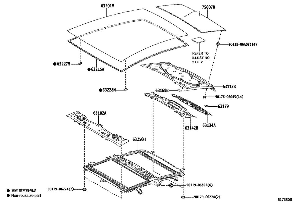

    Roof structures of the different types:
    Steel
    Glass
    Solar
    VelvetFoot and otatrant like this.

    You sure that is from a Prius manual?
    Some Toyota's come with electric smart glass but I don't think any Prius model offer it as an option. I have looked into adding it and maybe at some point I will get around to it. Supposed to do a good job at blocking the heat in summer. The new Nissan Leaf comes with it on their moonroof. Takes up less space than a sunshade.

    It's from the Prius manual, but it's absolutely not an option on the Prius. As far as I can tell, the only car that came with it was the last generation top-trim Venza. Not even Lexus uses it. (It's possible the Century also has it, but we can ignore that.) It makes me think it was a copy/paste error from the Venza manual. Either that or Toyota includes it for every single vehicle that has a pano glass roof, even if none of them use the one-touch frosted. I haven't checked to confirm or refute that.
    For those that don't know, the one-touch frosted glass(Star Gaze) is an electrochromic glass that is usually opaque, but becomes transparent when a specific electrical current is applied to it. The basic tech has been around for about 45 years, but it's historically been power hungry, fragile, and expensive. Putting it in a mainstream car(as opposed to something like a Bentley, RR, Maybach or Century) is pretty new. I'm guessing Toyota found it still wasn't quite ready, because it was only offered on the Venza and was never expanded into Lexus like you'd expect. (BTW, the glass is $6k MSRP to replace on the Venza, plus another grand or two for the modules that control it.)
    The Car Care Nut explains and demonstrates the Star Gaze glass roof in his review of the Venza from a couple years back.

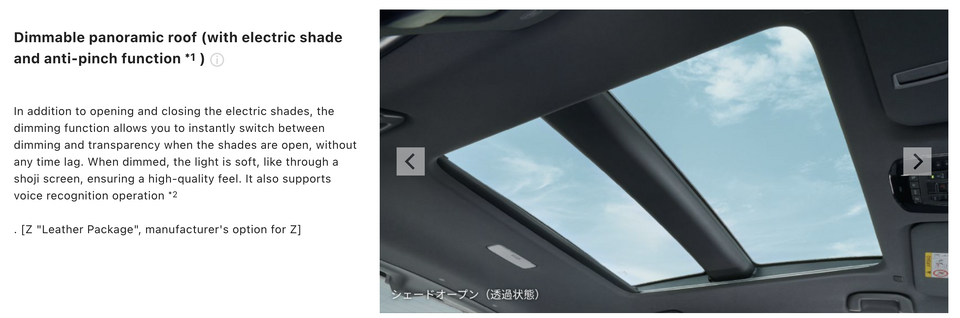

    It is an option on the 2025 Lexus RZ 450e Luxury AWD. With that being said is an interesting point about how it is missing from most of the latest Lexus models.
    It also appears to still be available on the Harrier model currently being sold in Japan.
    Harrier has both a shade and dimmable glass.
