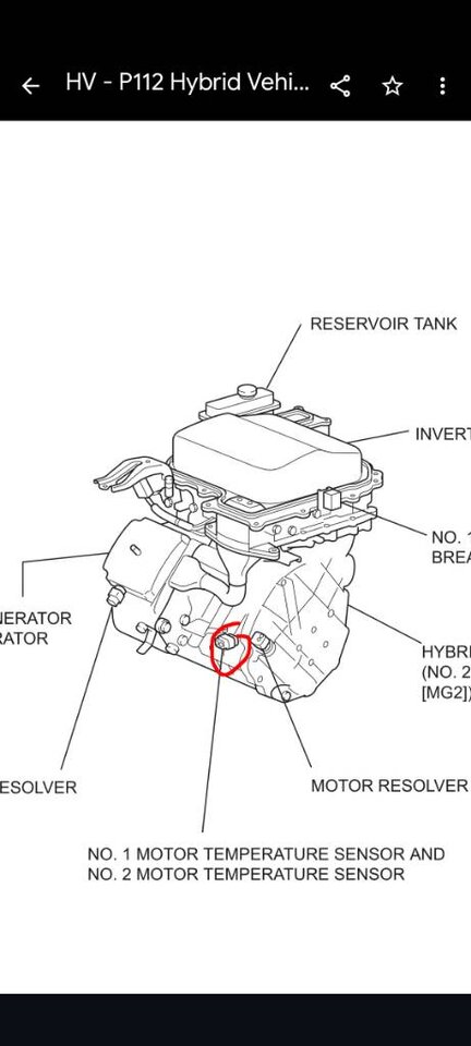

    I disconnected both the 12v battery and hybrid battery and let it sit for about 2 weeks. The C1310 disappeared but the P02AD is still there which states Drive motor "A" Temperature Circuit High.
    The car still starts and drives fine and the brakes works as they should but I do have the brake light ((!)) along with the Red Triangle light on. My hybrid battery seems fine and I never got the P0A80 code so I'm thinking my battery is still in decent shape. I tried to do the DR Prius app battery test but my battery is always not up to temperature as I am afraid to drive it or idle it to warm up and run the test again.
    Some say it's the ABS actuator throwing the codes but I hear it turn on and off as usual and others say there might be a problem with the hybrid battery ECU and it may have gotten wet.
    I'm at a loss and can't figure this one out. I ordered a hybrid ECU off of eBay and it's coming in the mail in a week or so. When that come in, I'll swap it out with mine and see what happens before trying to replace the ABS actuator.
