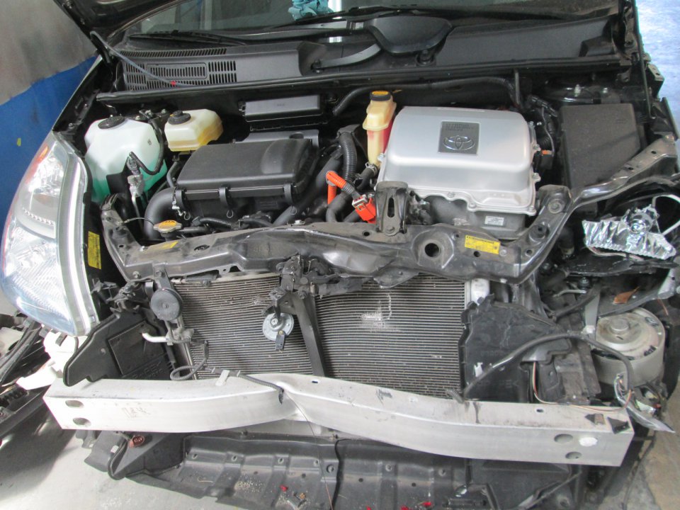

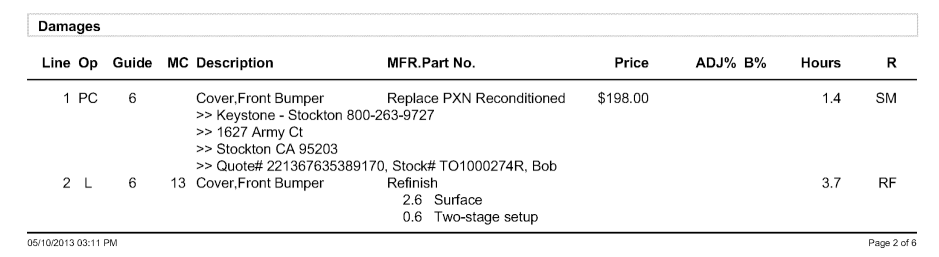

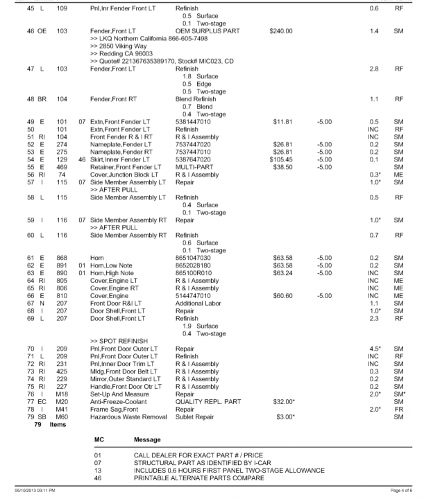

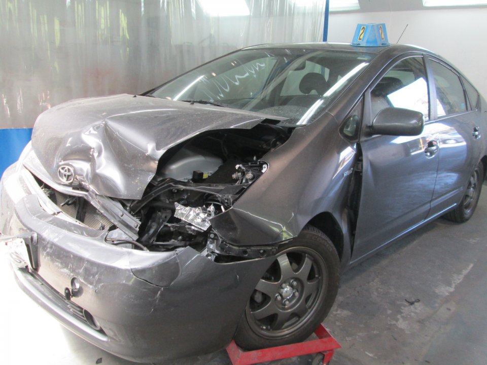

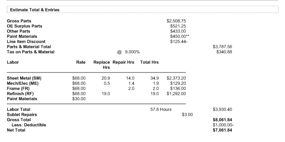

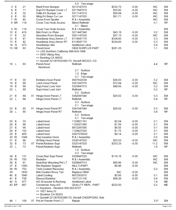

    Update time! After several days in the shop, they determined that my car is repairable. After some careful thought and research, I opted to proceed with the repairs, which are estimated to take 2 to 2.5 weeks.
    For your entertainment / horror, I'll provide the clearer snapshots I got from the auto shop, along with the parts-list from the quote and total estimated repair cost.
    Note that this is only the estimate from the "body shop" - while they will be replacing the AC system and radiator, the car will also be making a trip to a nearby Toyota dealership for additional mechanical review and repair (I don't have a quote for that yet).
    I'm highly skeptical that the car will ever feel the same as it did before the crash, but if there is continued interest I'll certainly update this thread again once I have it back and take her out for a spin.
    Thanks again for all the support and insightful / helpful comments - I really love this community!

    8 grande seems cheap, but i suppose you won't know the final number for awhile. still find it hard to believe it's worth fixing. what's the value, 12k?

    Before I decided about repair vs. replace, I ran the KBB value and got an estimated ~$17.5k, which is almost exactly what I paid just 2 months ago.
