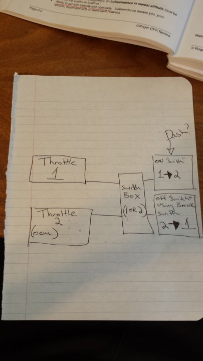

  10. FederalGnat
    FederalGnat New Member
    Mar 18, 2014
    Spokane, Washington

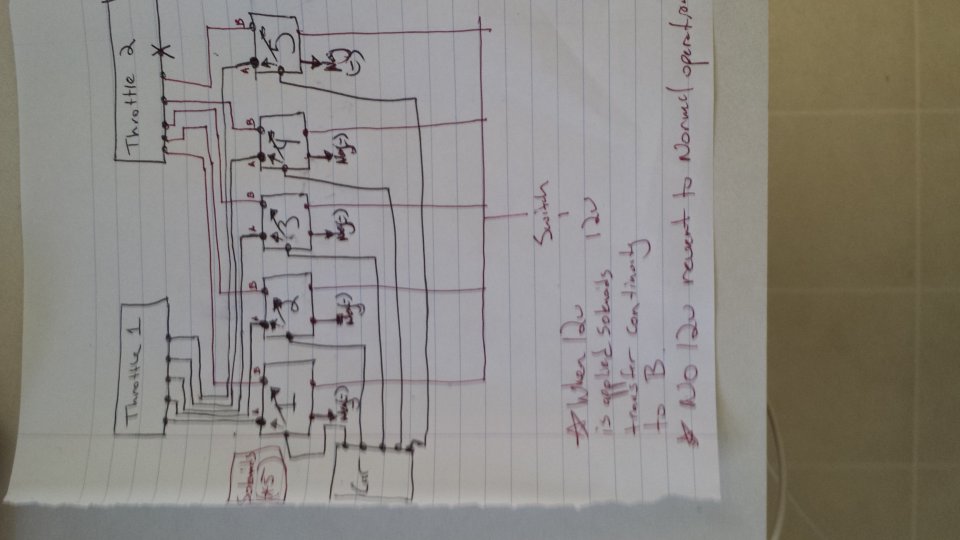

    What about an (A OR B Switch). I'm thinking of buying an extra OEM Throttle. Then having a selector switch that can select Throttle 1 or Throttle 2. Using the OEM Additional throttle I think its possible to switch from 1 --> 2 and back without computer noticing (fingers crossed).
    Need to find a multiple input switch that can switch all continuity to throttle 2 at flip of a switch (multiple connections simultaneously). Could use some sort of solenoid(s) but a (5x3) prong switch would be easiest. Need help finding that tho, not sure if that's available. ( Could be easy to add brake kill switch that reverts continuity to the throttle 1 which would be at zero throttle aka turn off throttle position holder). Brake kill switch probably involves solenoid(s) method (more difficult).
    P.S. I have lots of rolling hills in my area that I've found that if you keep a steady throttle position you can easily save on the mpgs. For simplify I could go without the brake off switch (throttle 2 --> throttle 1 @ zero mph), and just remember to hit switch prior to braking. Its still possible to stop if you forget (fyi).
    *Making a mechanical throttle holder/maintainer for throttle 2 shouldn't be extremely difficult.
  11. FederalGnat
    Mar 18, 2014
    Spokane, Washington
    See attachement
