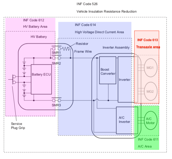

    Once you have the more-specific INF code, this diagram will show you roughly where to look. (This is a Gen 2 diagram, but the only change in Gen 3 is the A/C inverter is inside the compressor, so the cables to the compressor are part of the 614 area instead of 611.)
    If you end up needing a megohmmeter to test anything, the tool you mentioned is one, and should do the trick. If you don't already have one or haven't been trained on it, sometimes it's best to order one that will take a little while to ship, and spend the time boning up on the safe and proper use of a megohmmeter. A good source is Megger's publication A Stitch in Time, usually not too hard to find, for example here. Whatever information comes with a cheap megohmmeter will probably be too sketchy to learn much from.
    Before you have the more specific INF code, it's premature to think about testing the HV battery, as the code may tell you the issue is in some other area entirely.

    You should try to ready the car again, then re-read codes. The hybrid control ecu will first set the 526 INF code, and the next ignition cycle it tests further. Then it will set another INF, - 611, 612, etc depending on where it "thinks" the isolation fault is.

    Once you have the specific INF code telling you which area even to look in, just following the P0AA6 troubleshooting steps for that subcode in the repair manual will get you checking the right things the right way.

    What's weird is the brake actuator went bad, so I , after 2 tries with used parts, got one that worked. While repairing it, I discovered the Inverter cooling pump was bad. So I replaced that, bled the system, and now upon first start, getting all these codes:
    P0A75-341
    P0A78-286
    P0AA6-526-614
    Your attachment is really going to help, just waiting for my Megaohm meter to arrive today!

    Oh yeah, the attachment from SFO has the unclear bit that threw someone here before. You'll run into it, because of your 614 INF code.
    Notice that because you have 614, you'll be step 2(D) straight to step 19.
    In step 19 you'll unhook the frame wire from the inverter and meg from the frame wire's center conductors to body ground. That's a fair test, because the aft end of the frame wire is still connected, and you're essentially checking everything aft of the inverter. If everything aft of the inverter tests OK, you replace the inverter.
    Or, if that test turned out NG, you'll go to step 20, to start teasing out whether the problem is in the frame wire itself or something in the battery box.
    So in step 20 they tell you to unhook the other ends of the frame wire in the battery box, and again meg from the frame wire's center conductors to body ground.
    But remember in step 19 you already unhooked the forward frame wire ends from the inverter, and nothing told you to plug them back in, and those plug-in connectors also make the frame wire shield connections to body ground at that end.
    Back at the battery end, it's a little different. You can (and should) disconnect the frame wire ring terminals from the system main relays, without undoing the clamp that connects the frame wire shields to the sheet metal.
    If you get too enthusiastic and also undo the shield connections there (and they're already unplugged under the hood), then the shields aren't connected to body ground anywhere, and when you're told to meg from the center conductors to body ground, you're not testing much. :)
