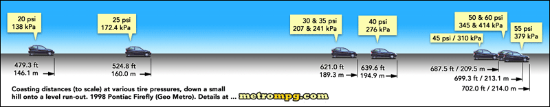

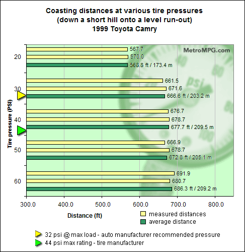

    My guess is that you are correct. The first 10psi or so below the max inflated pressure will provide the most "growth" in tire diameter. Beyond the max PSI there will be diminishing returns. This correlates well with experimental anecdotes regarding diminishing returns on decreased rolling resistance as one goes higher in pressure beyond the max psi. 50psi is where rolling resistance is fairly maxed out in the tests I have seen.
    Snapshot: effect of tire pressure on rolling resistance - MetroMPG.com
    Keep in mind that the test above was constructed to test rolling resistance from a dead stop then rolling down a hill as opposed to a coast down method which is what most hypermilers do when driving.
