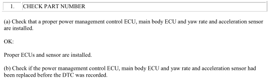

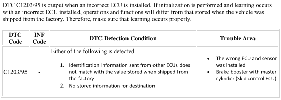

  13. ChapmanF
    26,218
    17,174
    The thing that can make you frown is getting a C1203 code. The skid ECU in your replacement brake actuator introduces itself to your car's power management control ECU, and main body ECU, and yaw rate and acceleration sensor, and gets unhappy if any of those three should turn out to be not what it was programmed at the factory to expect.
    ... which means, of course, that this can also happen to you if one of those other three ECUs ever got replaced with the wrong thing.
    The fix is to go replace whichever things need replacing until they are all the right things. Which might not be very fun.
    On the other hand, there is also this hint buried on the second page of troubleshooting:
    So this C1203 code is a strange animal. It either means you're hosed and have the wrong things and you're having a terrible day, or it means there's a simple calibration routine you should run.
    So the takeaway is you should never go immediately to feeling terrible if a C1203 shows up. First just try to do the linear solenoid calibration. If that works, you're not hosed.
    Brian1954 likes this.
