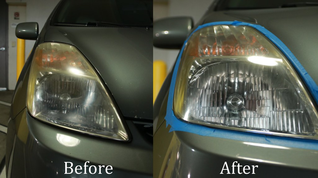

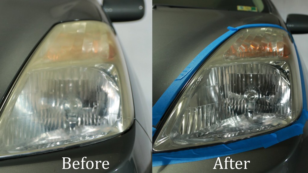

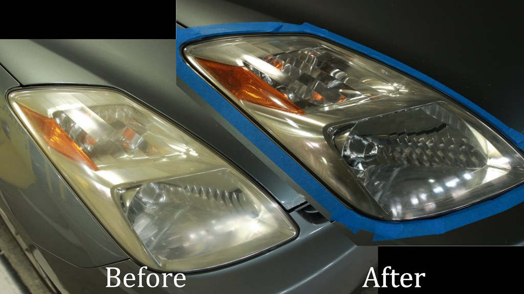

    I finally got around to fixing my tired-looking hazy headlights with Headlight Restorer by Chemical Guys.

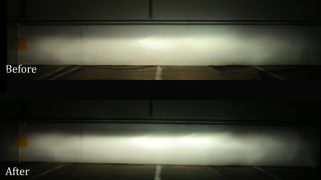

    The car not only looks better but also light output has improved (check out the last pic)
    The process is 1-step and overall it yielded good results for me.
    Check out the before/after pictures.
    [​IMG]B_A1 by Roman G, on Flickr
    [​IMG]B_A3 by Roman G, on Flickr
    [​IMG]B_A2 by Roman G, on Flickr
    [​IMG]compB_A by Roman G, on Flickr
    The cutoff after is much sharper which means less glare and better light down the road.
