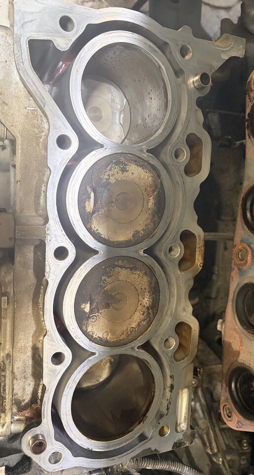

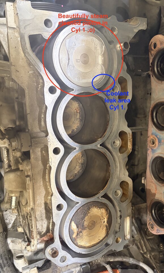

    A Prius V was in the repair bay when I pulled up for my Friday morning 9:00am diagnostic.
    My HG repair did end up running into Saturday, because the poor guy’s Prius V, after tear down, Cyl 1 had a bent rod! Not the result you want to hear. :eek:( That guy had to opt for the $3,250 refurbished engine option. Not a JDM swap, but swapping in a Refurbished engine (checked-out block, with a rebuilt head installed on it). Andres said his car had been maintained poorly. The pictures reflect that.

    Your engine was the classic steam cleaned. Probably a big leak. I think you were days or hours from a bent rod.
    There are definable metrics to establish a JDM engine is real and not US salvage. They have been posted several times.
    You do need to exercise the car well while under warranty. Letting any high mile gen3 sit more than a few days is a bad idea. Watch the oil consumption as well.
    In the end, you have dodged the blown engine bullet. Congratulations.

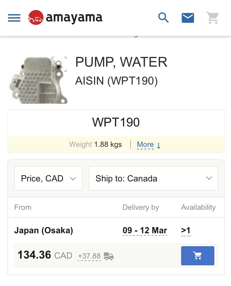

    That at least seems steep:
    134.36+37.88=172.24*0.73=$126~ (USD)
    https://www.amayama.com/en/part/aisin/wpt190
