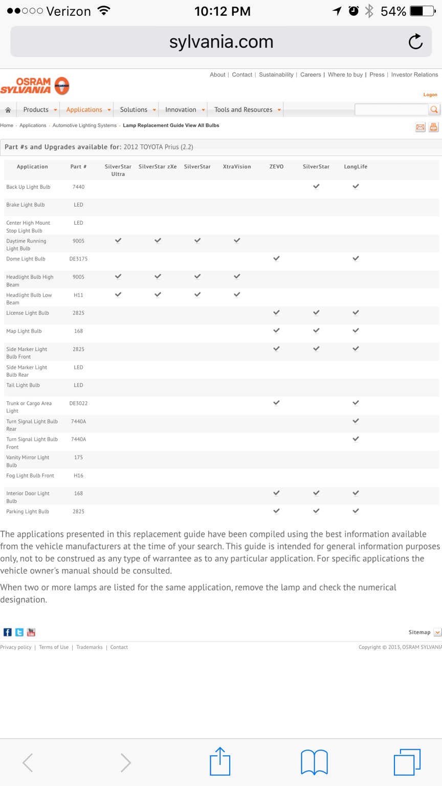

    H11 is gonna be ur size for the low beam.
    Sylvania H11 SilverStar Ultra High Performance Halogen Headlight Bulbs aregood

    image.png The reason I am confused about it is that Amazon.com say that such would not be compatible.

    Here is a guide
