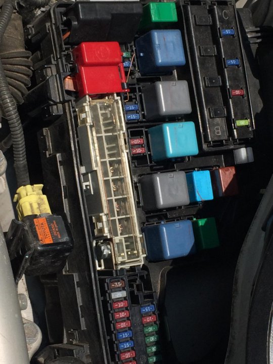

    Hi everyone - I popped the hood and removed the fuse over. I check the 15 and 10 fuses and they were ok.
    I saw the 6 inch or so clear top white like plastic box. It looks like the cover comes off, but I can see through
    the top. There appears to be a wire in each of the squares - some straight, some look like a partial 1/2.
    I do not see any burned marks. Can I ask what I should be looking for when checking or looking for.
    Does the cover come off? Does each square contain a removeable fuse like the way I am able to pull the
    a 15 and 10?
    To the right of the clear/white long box is a gray square fuse that I believe per the back of the fuse cover
    notes fuse for the HL-P Relay. Not sure what to do with this either. Does it pull out? Does just the cover
    come off. Sorry to be a pest - need help with the details. I posted a picture to help

    The entire fusible link assembly in the 5" long plastic box has to be replaced if any one link has blown. I don't believe the cover is meant to be removed because you can't really do anything once the cover is off.
    The grey square box is a relay, not a fuse. So if the relay map indicates it is H-LP, you have hit the jackpot.
    Now that you've looked at the fusible link and have not found any obviously blown link, the next step is to locate the H-LP relay and have someone turn the light switch on and off while you have a finger on the relay. Do you feel or hear it clicking? If no, then either the relay has failed or the wiring to it failed.
    You would then need a multimeter. Pull up the relay, measure voltage at the relay socket and measure the resistance across the relay coil terminals, which will probably be around 30 - 50 ohms. You also can test the relay by applying 12VDC across the coil terminals and measuring resistance across the switched terminals, which should be 0.5 ohms or less. And if you are gutsy, you can short the switched terminals at the relay socket to see if the headlights will come on, although around 10A of current will flow so expect some sparking if you do that. Make sure you are shorting the switched terminals, not the relay coil terminals.
