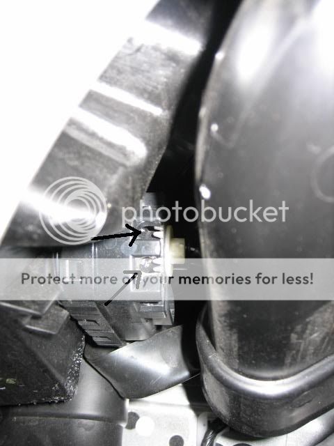

    Raise: Counter Clockwise from the driver's seat.
    When you turn the screw driver clockwise, the bottle cap looking dial will rotate CCW. Use the philips head screw driver as a gear set. The philips head will index with the bottle cap teeth.
    The arrows are where you insert the philips screw driver:

    Steamboat thanks for the picture.
    All of this makes no sense at all. Why the screw driver ?
    It just makes sense to turn the #10 nut...does it not.
    I was looking for a phillips head screw....
    Please see my pic-no place for a screw driver at all..wouldn't work .

    looking like you need an offsetting socket to me....a ratcheting wrench probably would not work.

    You engage the philips screwdriver into the slot as shown by the arrows. Not from the back, from the top/side. It would be a very tight fit to get a socket on the adjusting star.
    The groves to slip the philips into are very small. Here they are on my FJ, much better designed
