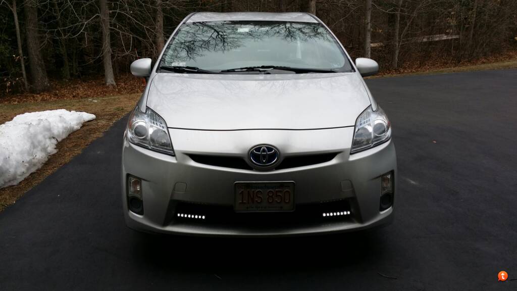

    So this is why I installed low power consumption Philips Daylight 8 drl led lights on my 2010 Prius.
    SM-N900V ? 2

    My swag is that your LED DRLs probably consume very roughly 90% less than the full headlights, a small but very real savings.

    Agreed. And my nephew tells me that the Philips drl add +10 hp given how good they look. ;-)
