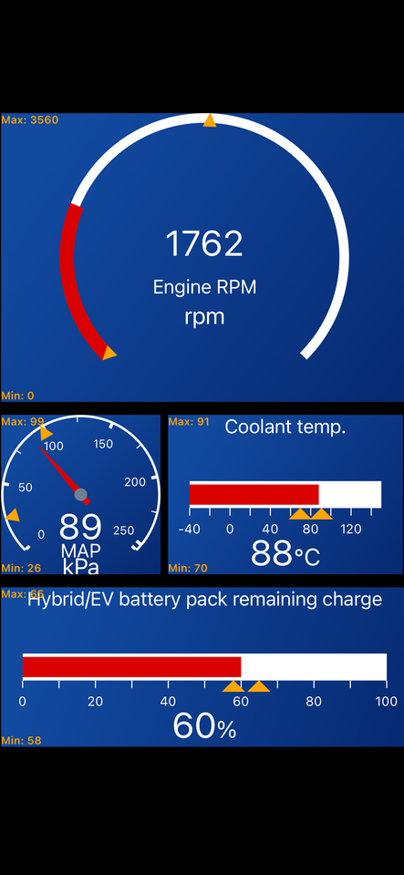

    - ICE coolant temp hovers around 88-91C (190-195F) - see below

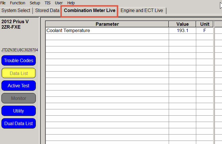

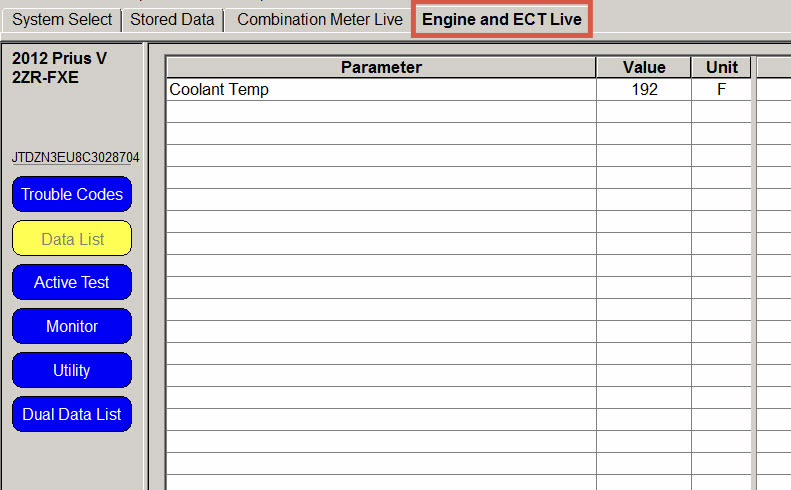

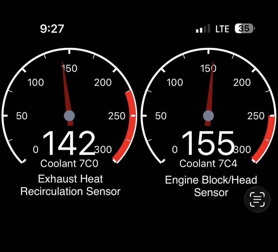

    1. Read second coolant temperature sensor located downstream of the heater and exhaust heat recirculation system. This is a dual passage cooling system.
    If there is air in the heater core the second sensor will be low.
    Techstream Sensors

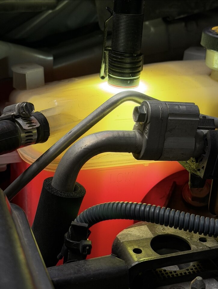

    3. Verify water pump flow in Coolant Reservoir when coolant has opened thermostat. Use flashlight to observe flow from top reservoir hose.
