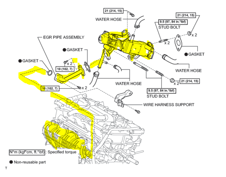

    This is the head gasket (item (1), highlighted in yellow):
    It's sandwiched in the engine, between the cylinder head (23) and the engine block (22)
    It's common for coolant to start leaking past the head gasket into combustion chambers, around your miles. I believe it to be due to carbon build-up in the EGR system, including the intake manifold (has EGR passages), the yellow highlighted components:
    Symptoms of head gasket failure are:
    1. Dropping coolant level in engine coolant reservoir
    2. Engine shaking on cold-starts.
    In my signature there's links related to head gasket failure, and EGR cleaning. On a phone you'll need to turn it landscape to see signatures.

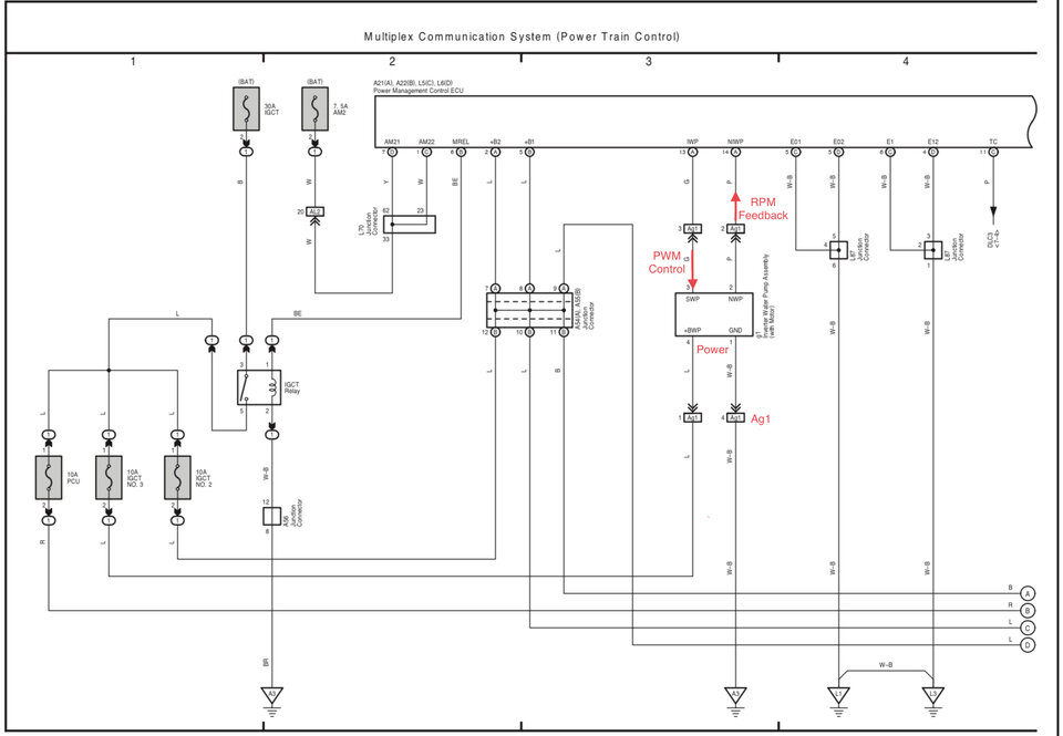

    Odds are good the inverter coolant pump issue is unrelated to the engine head gasket. However not seeing movement or rippling in the reservoir (driver's side) means it is not working.
    The pump should always run in Ready mode.
    Be sure you check the connector's power and ground. Power to chassis bypasses the pump's ground circuit which could be bad (unlikely).

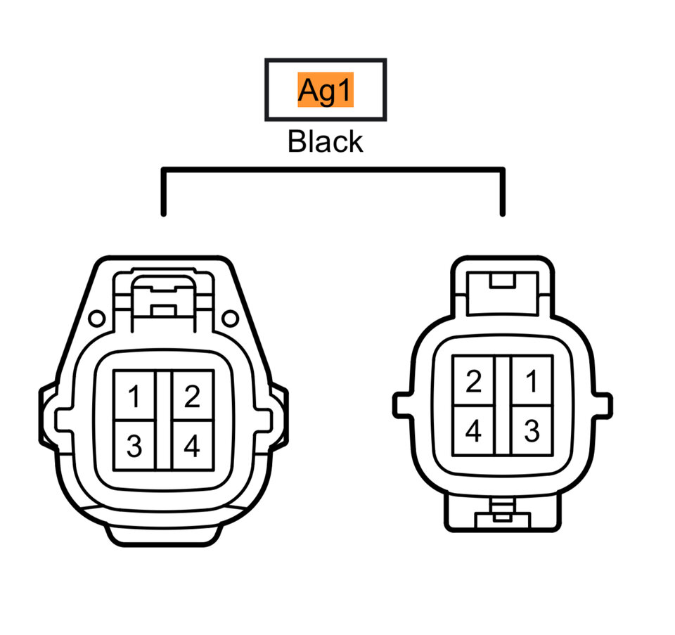

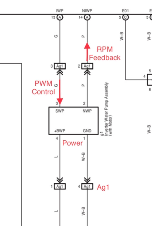

    The pump speed in controlled by a pulse train pwm input (pin 3) and the ecu receives a pulse train rpm (pin 2) feedback. These require an oscilloscope or scope meter to check properly although the wiring continuity can be verified with a standard ohm check.
    My bet is the replacement inverter pump is bad. Almost guaranteed if it was aftermarket or used.

    Assuming the inverter coolant pump is not running, I suspect your shop will find one of the following in this order:
    1. Bad pump receiving proper 12v and ground
    2. Bad pump ground wire connection
    3. Bad pump speed control wiring
    4. Bad temperature thermistor although normal faults have specific codes
    5. Bad Power Management ECU
    The reason I think bad pump receiving proper 12v and ground is you said the power was checked. Hopefully the ground was checked at the closest pump connection.
    It might be possible the pump is running but not moving enough coolant due to a defect.

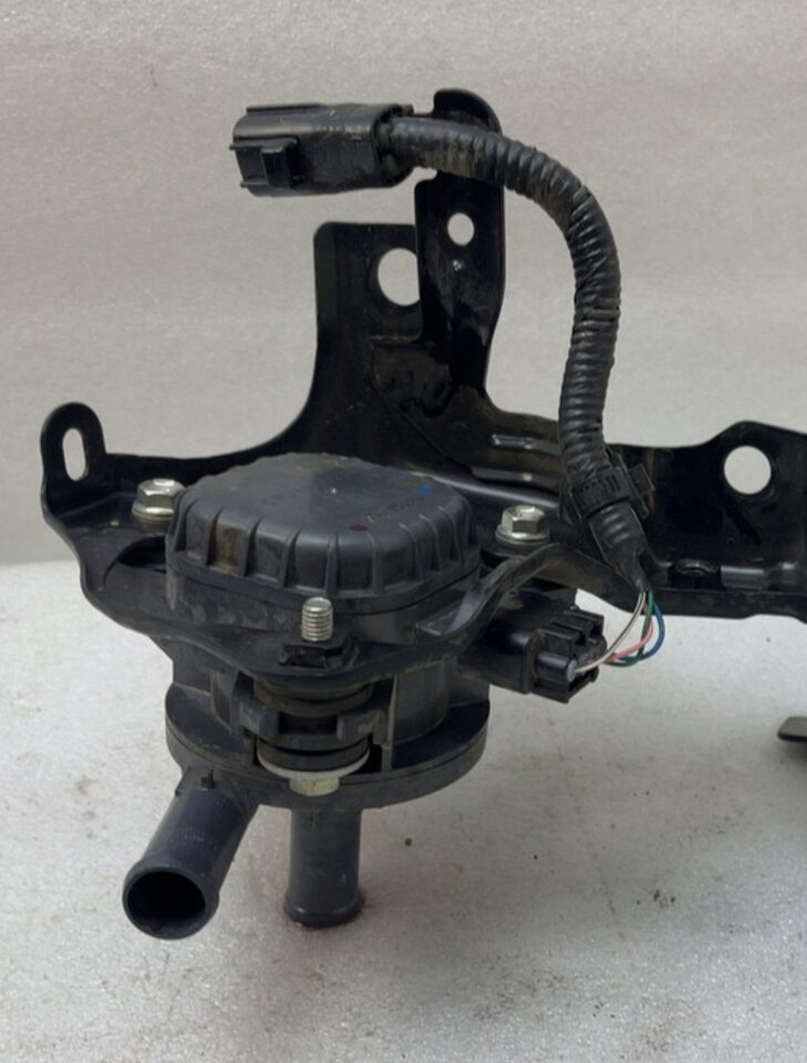

    I will follow this procedure during the measurements. Thank you very much. A new pump has been installed. However, I should mention that the heat pump is a counterfeit product, not an original. When I carry out further measurements later on, I will be able to determine whether the pump is causing the issue or if something else is the problem. I will keep you informed. Thanks again.
  20. Brian1954
    Brian1954 Senior Member
    Jan 31, 2021
    1,699
    663
    South Central PA, USA
    When you are saying "heat pump", I assume that you are talking about the inverter cooling pump. If that is correct, then you are saying that the inverter cooling pump is not a Toyota OEM pump and that it is an aftermarket pump. Many aftermarket pumps do not work correctly. Most will work for about a year. Some will not work when you take it out of the box. This is what others are trying to tell you. The most probable reason you are still having problems with your car is that the new aftermarket pump you installed is not working because it was defective.
