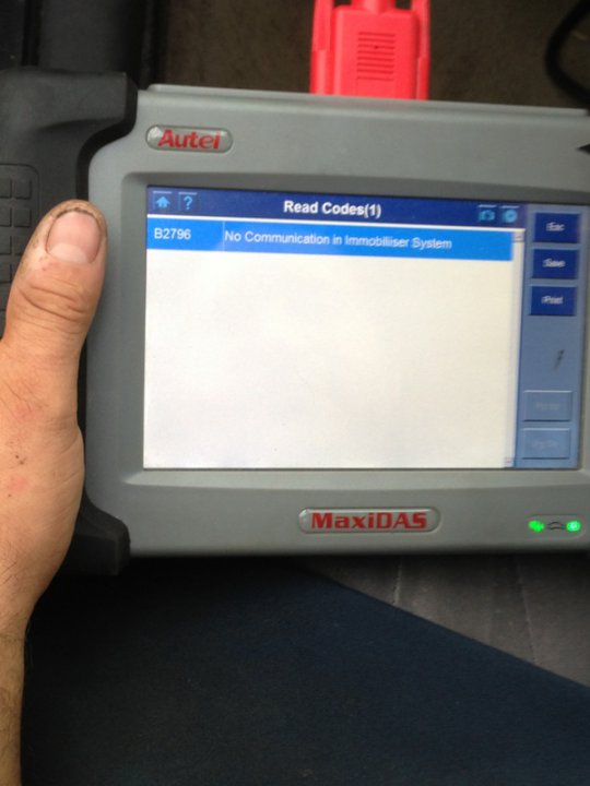

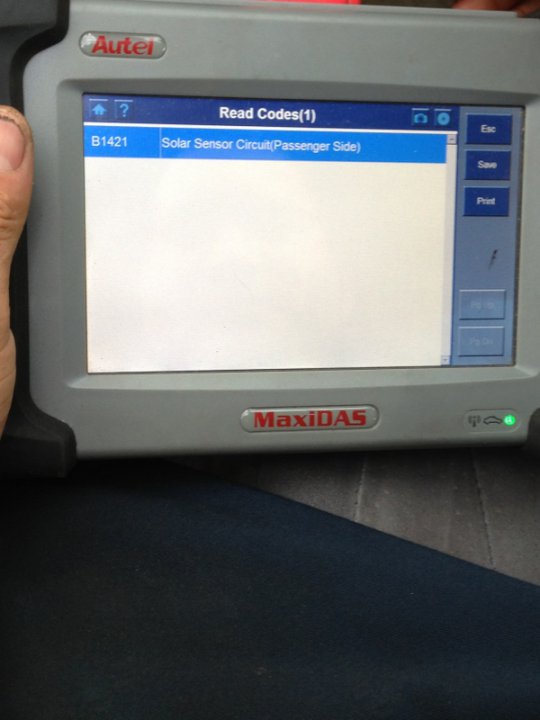

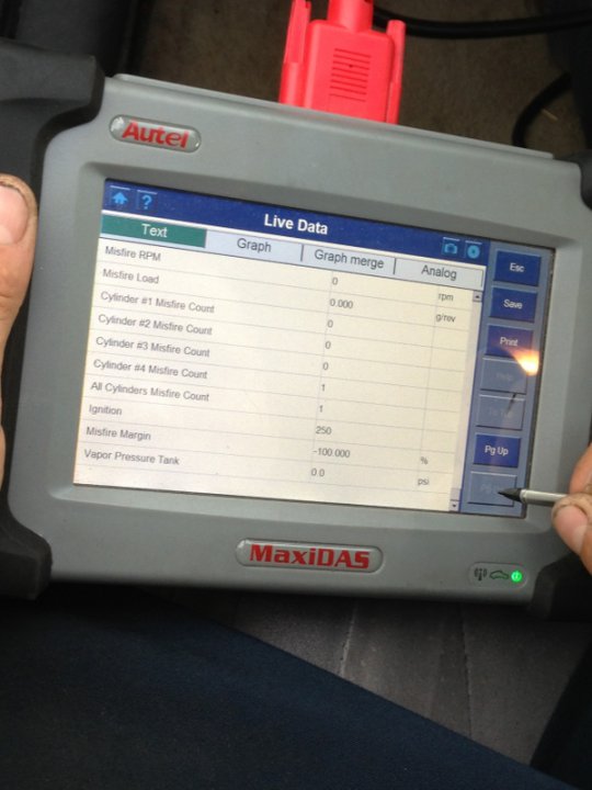

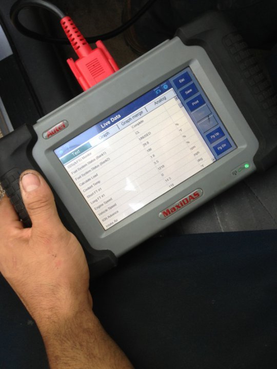

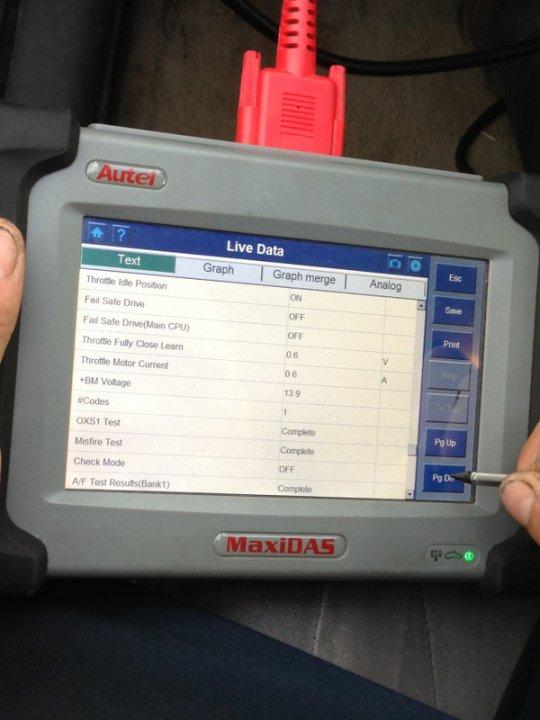

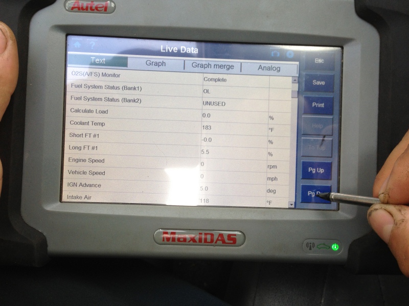

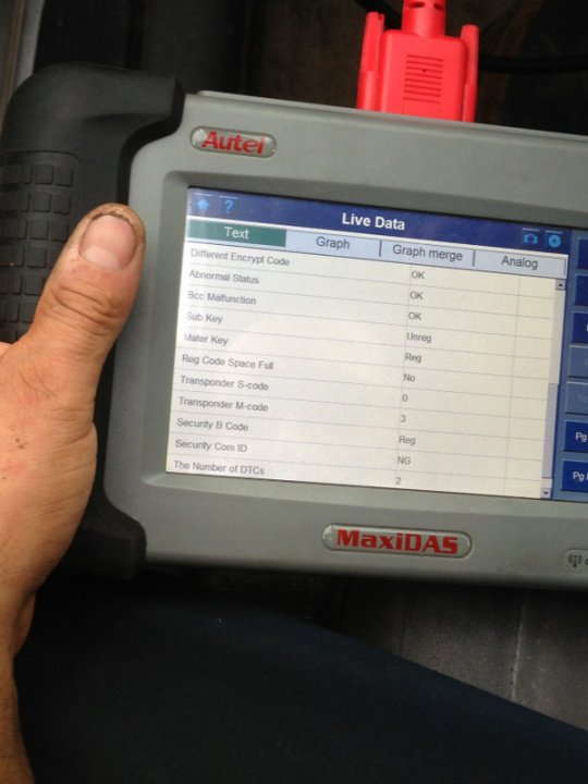

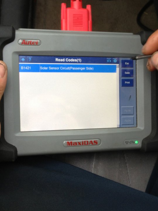

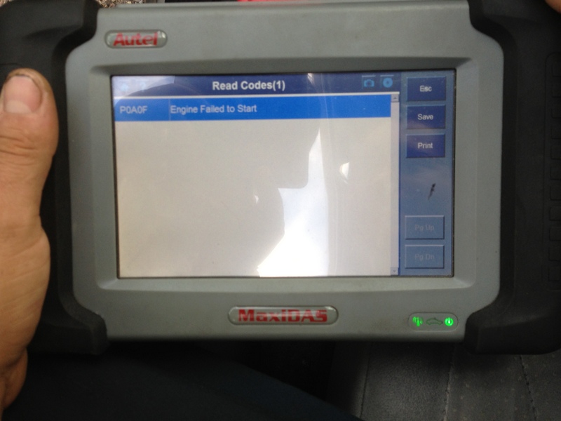

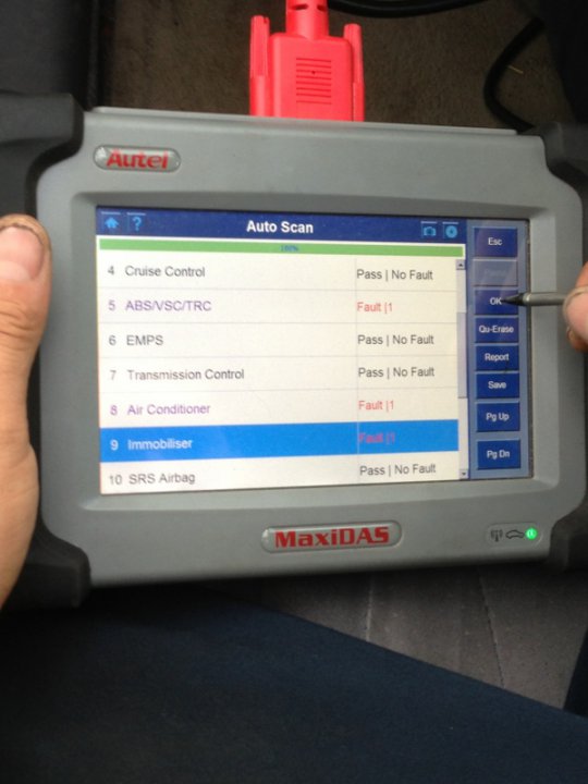

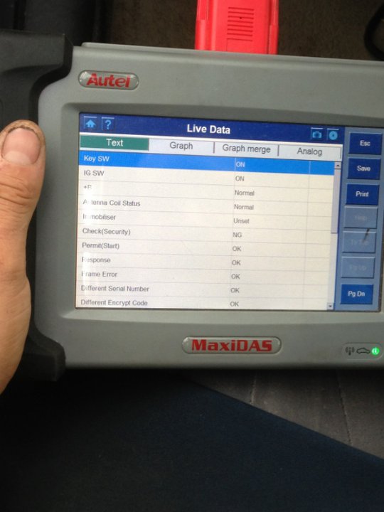

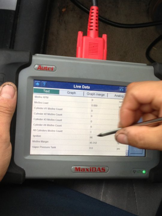

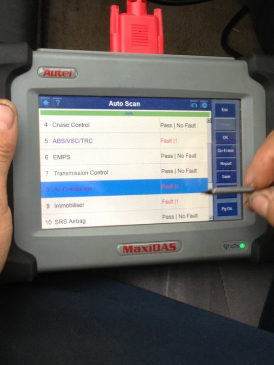

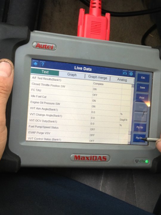

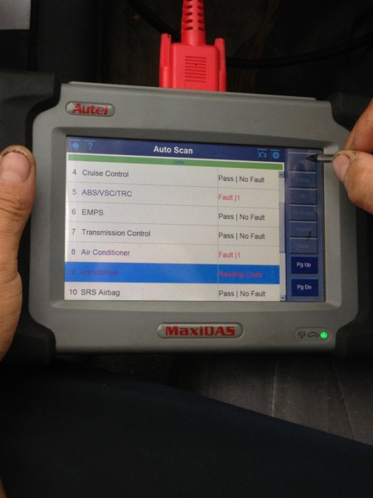

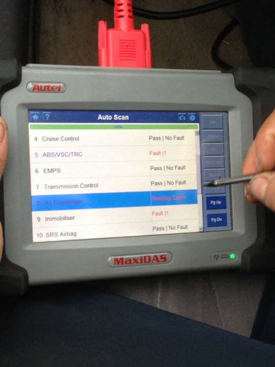

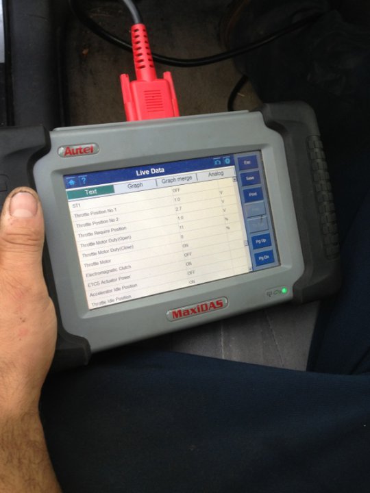

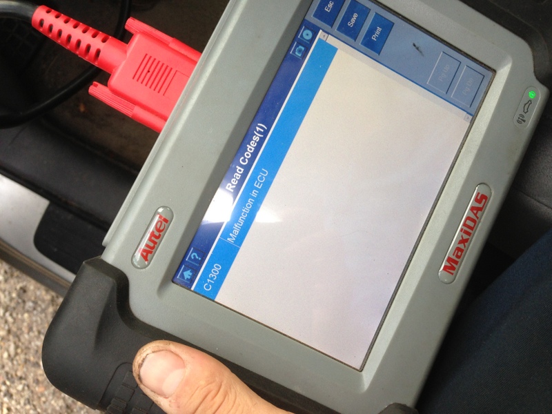

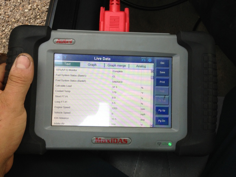

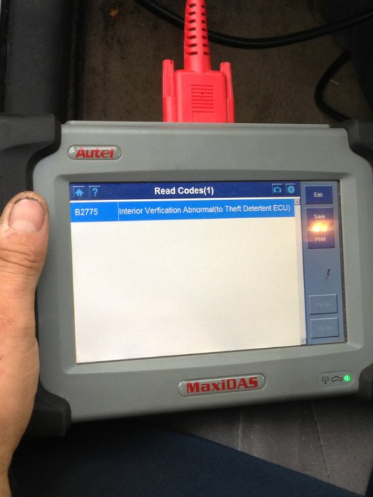

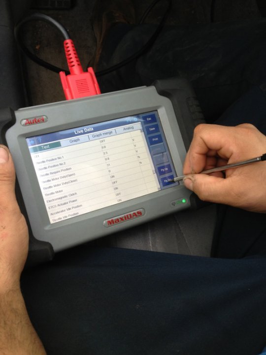

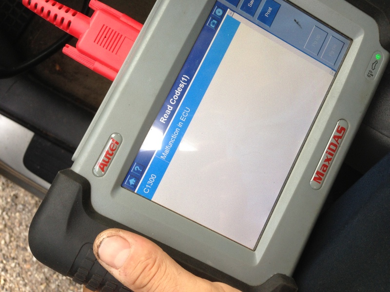

    The engine light went on and I took it to my mechanics who is good on everything except Hybrid system. I took some photos when he looking at the code. He wants me to leave the car during weekdays, so he can do detailed check, and call dealer for help if need to. Just looking at the codes, he has no idea what's gone wrong so far.
    Immediate after the lights on, I filled gas and the mpg dropped to 31, soon back to 37 on a hot day 85 degree. At red light, I feel the engine still running, not very smoothly. But the next day, it back to normal, mpg also back to 48 something.
    My friend has a 2005 with 140K also got the same code. His mpg dropped to 40 and feel that engine power is lower now.
    I would like to know if this is a common problem, what's the most probable cause, and if there are many possibilities, what's the best way to approach (change this cheap parts first, see if it solve the problem...).

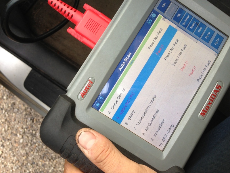

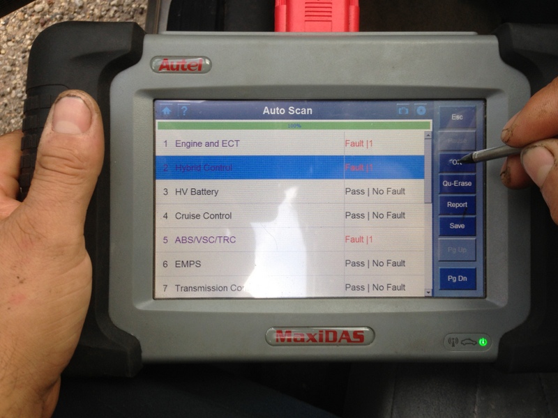

    Here is problem area by OBD-II:
    Engine and ECT
    Hybrid Control
    ABS/VSC/TRC
    Air Conditioner
    Immobiliser
    At one time I completely ran out of gas and the battery was at the last two bars when I glide into gas station :( Some messages may caused by this.
    IMG_0048.JPG IMG_0049.JPG IMG_0050.JPG IMG_0051.JPG IMG_0052.JPG IMG_0053.JPG IMG_0054.JPG IMG_0055.JPG IMG_0056.JPG IMG_0057.JPG IMG_0058.JPG IMG_0059.JPG IMG_0060.JPG IMG_0061.JPG IMG_0062.JPG IMG_0063.JPG IMG_0064.JPG IMG_0065.JPG IMG_0066.JPG IMG_0067.JPG IMG_0068.JPG IMG_0069.JPG IMG_0070.JPG IMG_0071.JPG IMG_0072.JPG IMG_0073.JPG IMG_0074.JPG IMG_0076.JPG IMG_0077.JPG IMG_0078.JPG
