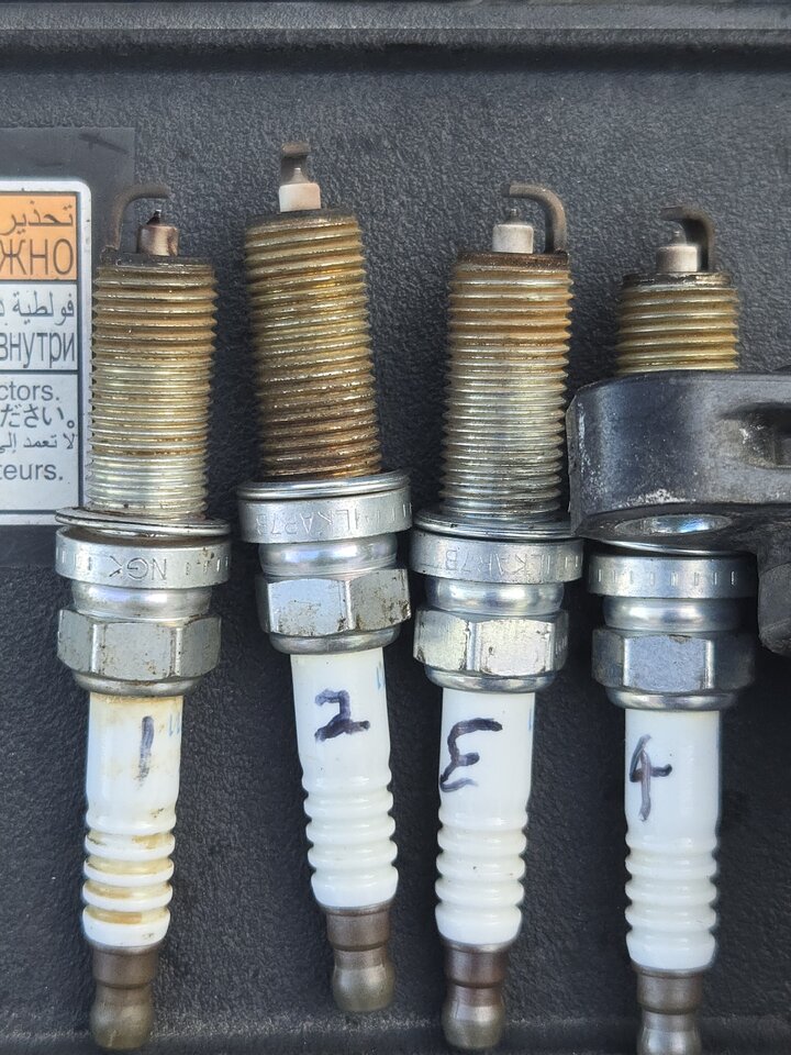

    I just bought a socket wrench and checked the spark plugs. They are relatively clean. The ceramic part of the spark plug of cylinder 1 has some stains. Cylinder 2 is not tightened enough, so there are marks on the threads.
    I am going to try to change a set of spark plugs first.

    The spark plug shows that the combustion condition of cylinder 1 is not good.

    The conventional old school head gasket tests often provide false negatives including checking for combustion gas in the coolant (bubbles or using a combustion gas test kit). Compression or leakdown tests also provide false negatives on the engines. An early stage gen3 Prius hg fail leaks a few drops of coolant into the cylinder causing a temporary misfire.
    Typical misfire sources like plugs, coils and injectors don't just go away. Many hundreds of diy'ers and mechanics waste money chasing those solutions. Sometimes they add problems using cheap aftermarket parts.
    However replacing or swapping plug 1 might be relatively low cost even though you have to remove the entire wiper assembly and support sheet metal to access the plugs and coils. If you are going that far you could just swap number 1 and 4 plugs and coils and see if the code moves to cylinder 4.

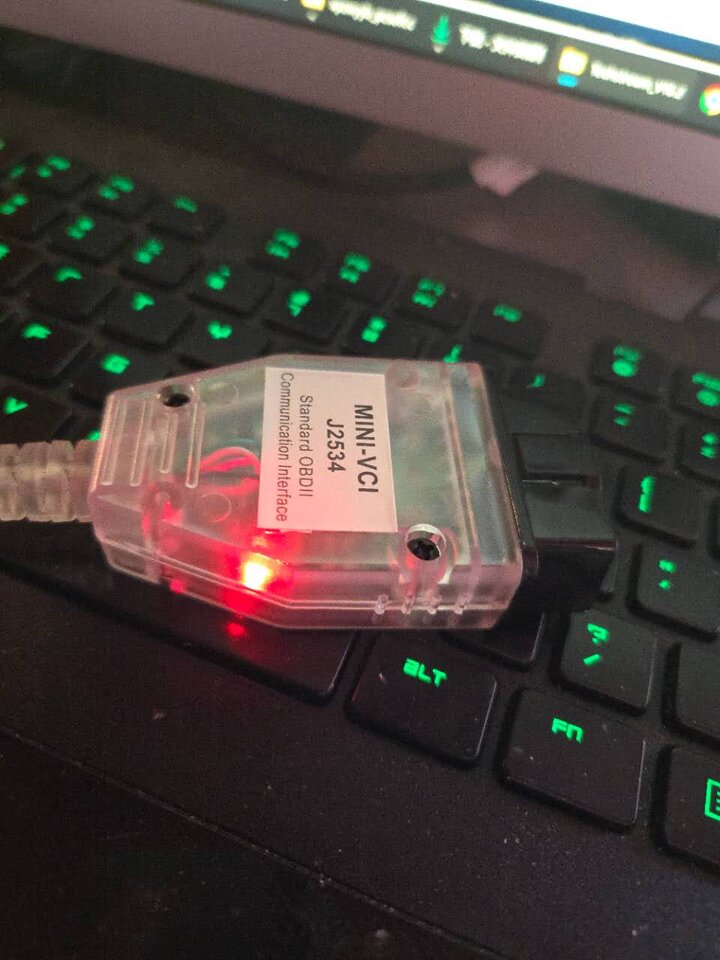

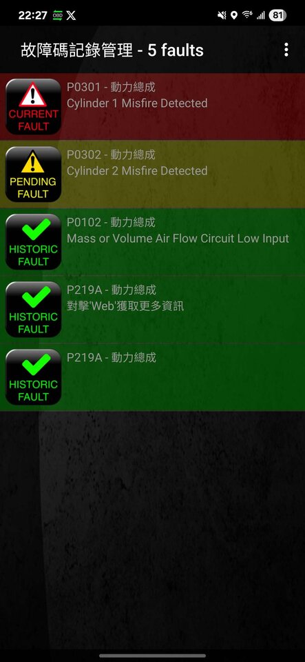

    MINI VCI OBD 已经到货

    Misfires on cylinders one and two, the usual with head gasket failure.

    The pics add nothing to the situation. Borescope.
