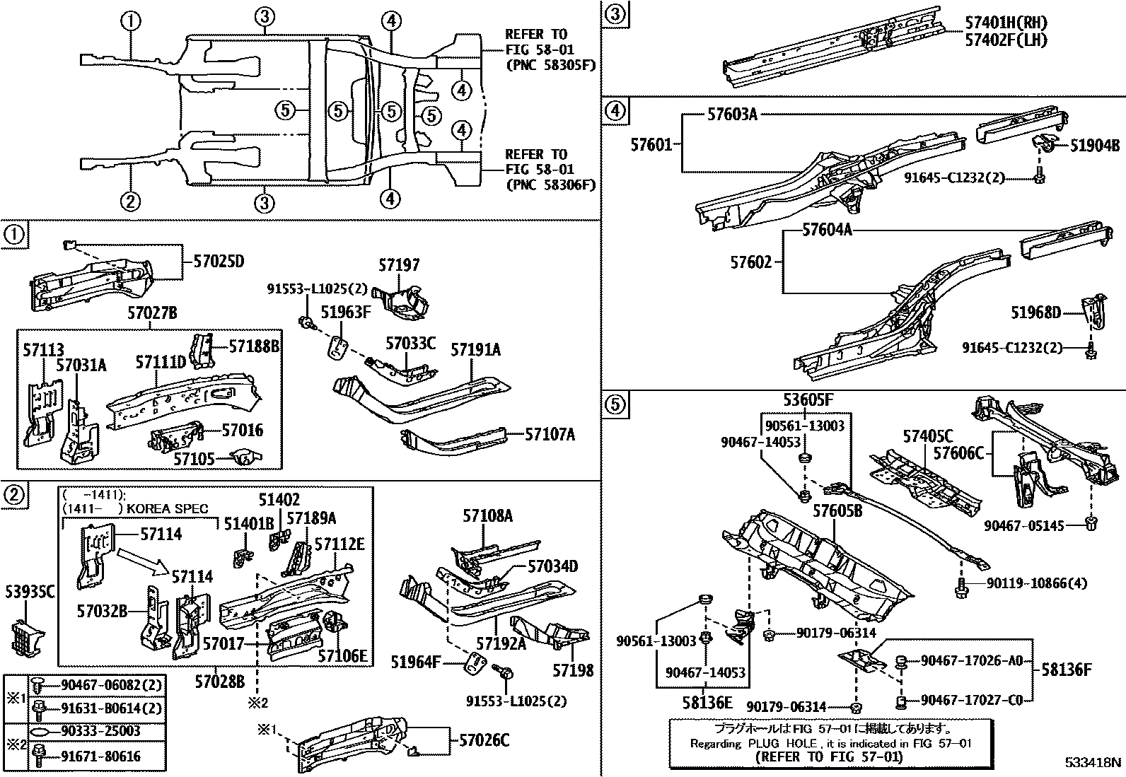

    I found that diagram (or a similar one to it ) @MAX2 posted above in #11 at https://www.amayama.com/en/catalogs/toyota/prius
    I also looked at the list of models that diagram on the amayama site includes parts for to make sure the 15 Prius V was included, which it was, but there were 128 other models listed too. :coffee: please.

    Hi everyone, thanks for all the help and suggestions. I appreciate it, even for such a simple thing. I ended up getting parts 90467-17027-C0 and 90467-17026-A0 from the dealership for about $6 total. And I learned that the dealership's employees are less than worthless. You would think that bringing the car in and pointing at the black plastic part that was hanging off it would be enough for them to do even a little work to identify the part and then sell it to me. But Nope! Not my dealership. I asked if anyone in the service department would know and they offered to book me an appointment and pay a diagnostic fee. As far as I am concerned, they do not deserve any loyalty and should be treated as just another vendor, with price alone being the determining factor. Okay that's my rant.
    The back plastic part 58168-72010 had a large split in it so I was considering buying a new one, but $95 seemed too much. So I decided to try welding/melting the plastic back together using sunlight and a magnifying glass. It worked really well. Just warmed it up with the intense light, not the focal point as that is too hot and will burn it, and smush it back together with a butter knife. 1738809548619.jpg
    Also hardware store hardware will only work for one connection spot. I'm not sure why they decided to design it like this, but the two through holes are not at the same level. 17388092303111.jpg So you need this nut toyota part 90179-06314.jpg or similar hardware for the left hole and this pair of clips for the right one in my picture. toyota 90467-17027-C0 90467-17026-A0.jpg
