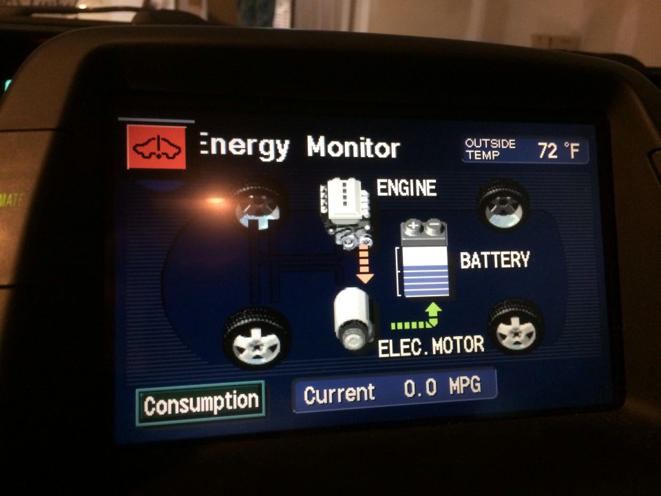

    1. Does the MFD display a warning icon in the upper left corner? If yes, pls take a photo and post.

    Thanks for the responses so far. I have uploaded a pic of the MFD. Hopefully someone can tell me what it means. As for the 12V battery. I have not had it replaced - so that an item to address. She has over 100K miles. Not exactly sure the current mileage. Appreciate the inputs! I'll keep posting updates. Thanks!

    The icon showing the outline of a car with an ! superimposed means that the hybrid vehicle system has a problem. Well, you already knew that.
    It doesn't hurt to make sure the 12V battery is in excellent condition, but I believe your car has more issues than that.
