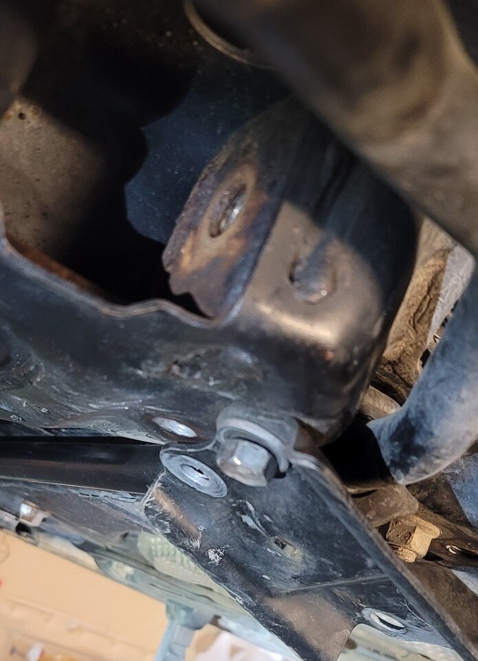

    I am quite stuck, and in need of some wisdom.
    CONTEXT
    • 2011 Gen3 Prius. I am replacing the sway bar bushings (see Mendel's shared PDF, pp 37-38)
    • To remove the LH bushing requires (according to service manual) removing the LH Front Lower Suspension Arm (attached to the Front Suspension Crossmember), and the Front Suspension Member Front Brace, which is held on by four bolts.
    A Not-So-Tiny Problem
    • Unlike other generations of Prii, this one isn't as simple as described.
    • The right side, I didn't even need to remove the control/suspension arm, just the "Brace."
    • The left side? Auuugh! One of the four bolts is NOT held in by the metal it bolts to. It has a hidden nut.
    • Please see photos below...
    I assumed I could access the nut by removing the LH control/suspension arm. WRONG.
    • Said nut is inside the Front Suspension Crossmember!!!
    • Said nut is NOT listed in the parts diagrams for my car
    • Nor is there any explanation of how to grip it to install or remove the bolt that holds the 'brace' for the sway bar bushing.
    I need ideas, experienced input, wisdom.
    • How can this be? (My guess: perhaps the nut was originally tack-welded in place?)
    • Any ideas how to hold the nut through the lower suspension arm bolt hole, for removing and later re-installing the wayward front brace bolt?
    • Is there any recourse with Toyota for such a hare-brained design???
    In the photo:
    • Above: the front suspension crossmember...
      • With slot for the control arm bushing...
      • And holes for the control arm bushing bolt, inserted on left.
      • The hole is 14.5 mm
    • Below: you're looking at the Front Suspension Member Front Brace, held in place by just one bolt, aiming (upward) into the bottom of the Front Suspension Crossmember
    • (Off to the right is the sway bar)

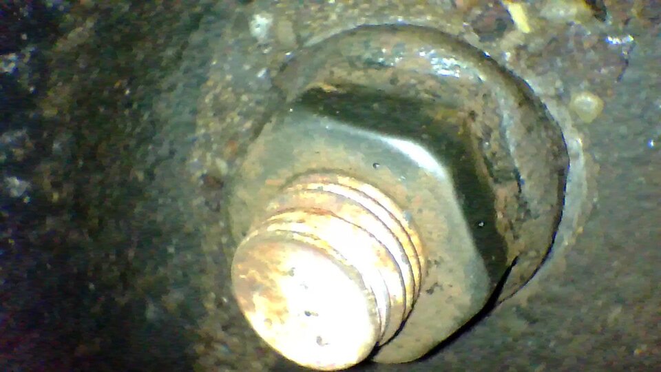

    Photo below: taken with USB cam inserted into the 14mm suspension arm bolt hole in the side of the front suspension crossmember. You're looking at a 17mm nut.

    Have you confirmed the nuts spins when the bolts spins? It's hard to tell without more photos, but that nut looks to be adhered to the metal, just not as well as usual. sometimes you can use a giant screwdriver or custom shape iron bar and wedge it in there in a way that holds the nut. But more likely, you're supposed to remove more stuff to access the job on that side of the car.

    I agree, jam a large screwdriver, breaker bar, or pry bar against the nut flat face to hopefully prevent it from turning.
    Also, do you have an impact gun? If you use penetrating oil on the bolt/nut, then hit it with the impact driver while keeping the nut from spinning with the pry bar/large screwdriver, it will hopefully break free. The impact driver can impart much more force, quickly to the stuck nut than you can using hand tools.

    Yes, absolutely spins. And yes, confirmed it is loose in there.
    I kinda assumed I need to remove more stuff... but don't see what can be removed that would help: that big hunk of metal is all one part on a Prius! It is the Front Suspension Crossmember.
    Yes, I have a powerful impact gun. My next step is going to be to use the bolt hole to squirt some penetrating oil on the nut and wait a while for it to work.
    I do own a right-angle crowbar. Not sure I can get it to fit in there, but something like that may help.
    My other thought is to use the magic of modern chemistry: perhaps there's a super strong adhesive I can squirt in there to hold the nut... or perhaps to fill the space between the nut and the side of the metal box, and keep it from turning?

    Can you drill a small hole (3-4mm) up into the crossmember right up against the flat of the bolt-head, such that the drill passes through the flange in the nut on the other side?
    Then hammer in a pin to index the the flange nut to the crossmember and get freshly busy with the impact tool?

    You need to get a wrench/socket/crow on that nut. If disassembly does not give you access...how are you going to tighten it back up?

    The job is done. Whew...
    Here's what I ultimately did:
    1. I have no piece of metal rod that can work it's way to jam against the nut.
    2. I am cautious about integrity of the metal car frame...
    3. I tried one more time simply using a crowbar to provide pressure, and my torque gun ($99 Hyper Tough High Torque #80287, 3 year warranty FTW!)
    Result: there was a little more movement, enough to carefully spin the plate out of the way and replace the sway bar bushing!
    4. Stared at the puzzle for a bit, and chose a mechanical solution for tightening the bolt... I tightened the plate-body connection instead of the bolt-nut
    5. Inserted two stainless sell washers next to the wayward bolt, filling the gap between plate and body.
    Tightened everything down, and it is solid.
    NOTE: the plate is already compressing a bushing that more than fills the available space. I seriously doubt I have added any real risk.
