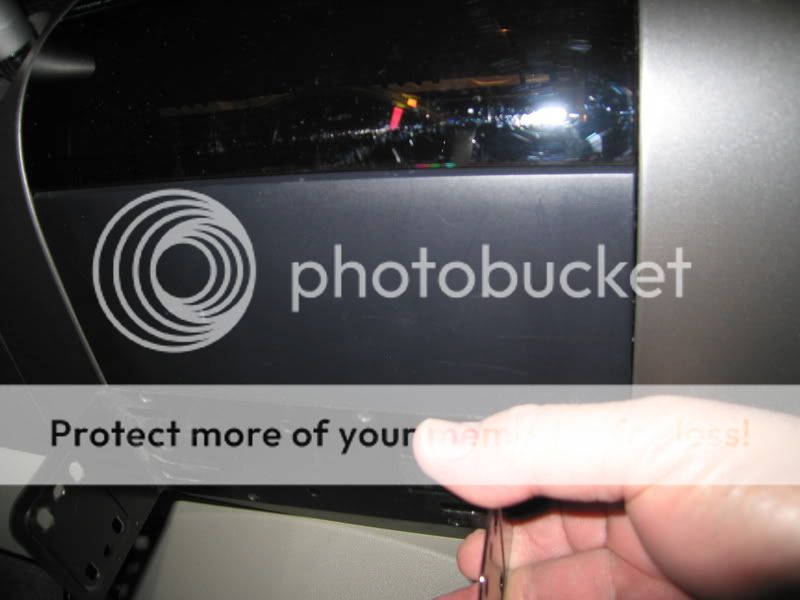

  6. Halpert2
    Halpert2 Junior Member
    Jan 28, 2007
    Vacaville, CA

    You need to remove two screws on either side of the panel (hidden behind the air vents) then the panel pops out. I would start on the passenger side and work my way over to the driver side. Once you have the glovebox and passenger air vent removed you can see behind this panel.
    Here's the link to the link to the dash disassembly instructions:
    http://priuschat.com/forums/prius-technical-discussion/34541-dash-disassembly-pdf.html
    I don't recall if there is a metal panel behind this piece - I think it's just reinforced plastic ribbing. I'd opt for machine screws with a washer - self tapping sheet metal screws will eventually pull out unless you hit a substantial piece of plastic or have a backing.

    Halpert2 - Thanks for the great photos! I just need the patience and time now to get the dash apart without beating up my interior! Best wishes.
