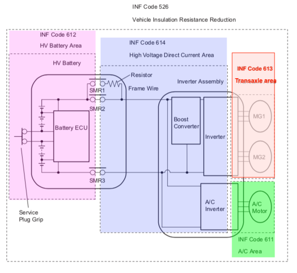

    With a P0AA6, you really want to read trouble codes with a tool that will show you the INF codes. As you can see, there are four different specific ones identifying different areas to look for the leak. If the code you have isn't a 612, then when you're in the battery you're not even looking in the right part of the car.
    We have a recent thread reviewing diagnostic scan tool options for Gen 2 and which ones can give you the INF codes.
    The safety plug would be a different code, P0A0D.
