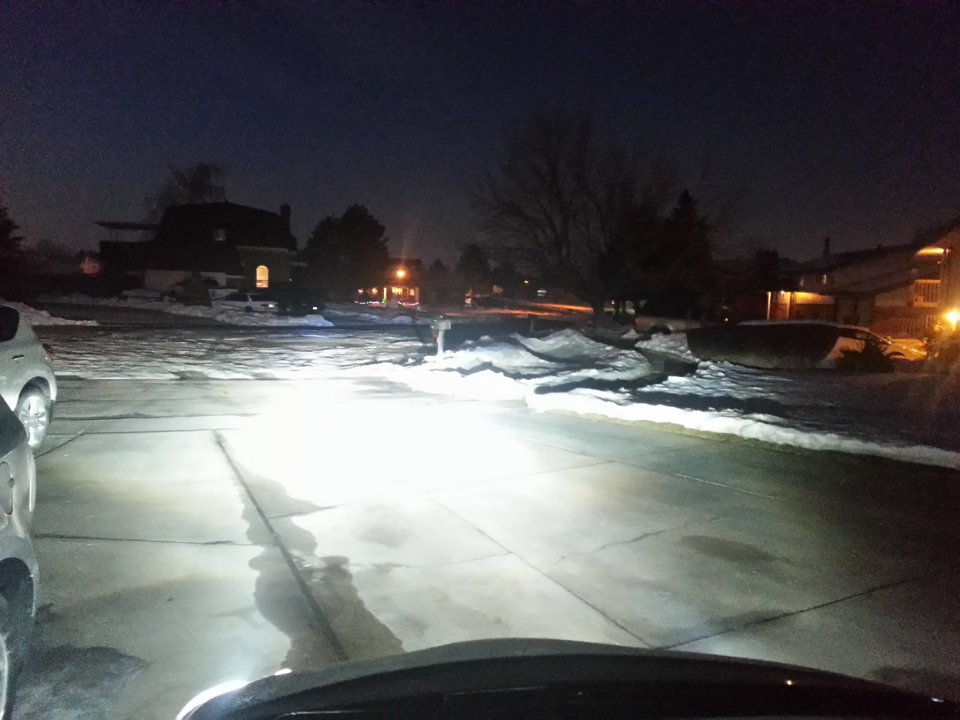

    bino do you have a picture of your headlights on?

    MKART Junior Member

    I'll try to
    I'll try to find one.. but my headlights are not hid they are led
