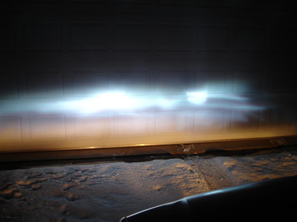

    I would be interested in seeing a picture of the beam pattern against a wall at 30 feet. Every conversion kit I've ever seen produced a beam pattern that was inferior to the original with hot spots and scatter.
    Like this guy who put a conversion on a Ford Pickup:
    He's too close to know how bad the scatter is. ...
    Perhaps the Prius's projector design can accommodate the HID's without issue, but almost all cars exhibit poor performance.
