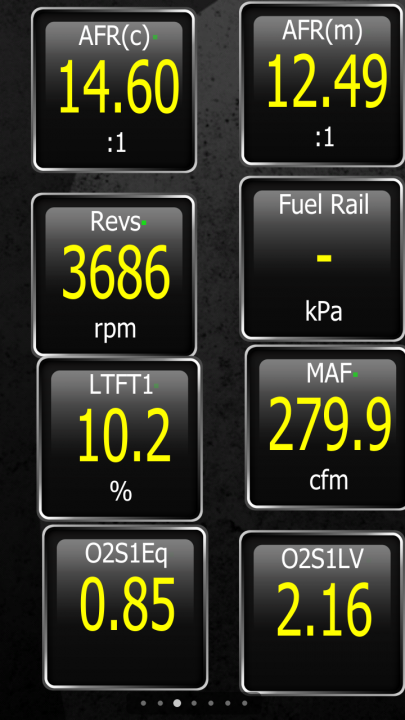

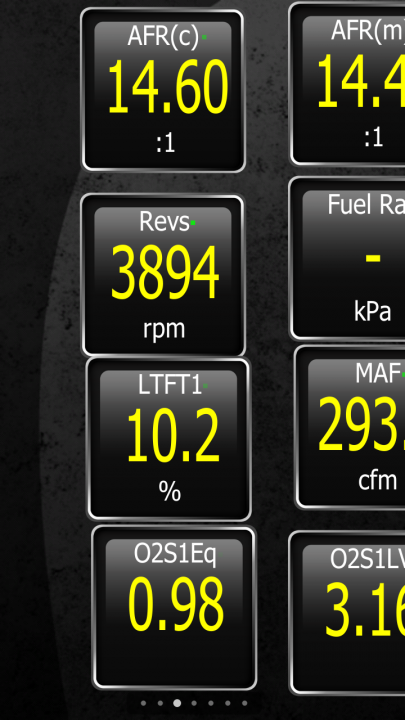

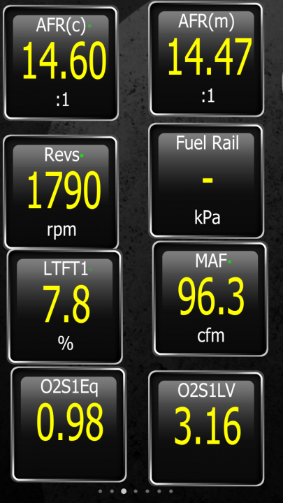

    Looking at Torque: 70mph cruise is pulling 120 cfm air intake. Pushing throttle down 90% at loss of power then shows about 290 cfm air intake - so I'm guessing it's not a clogged cat, because it looks like air is flowing.
    However, looking at the air fuel ratio - MEASURED under high throttle, this is swinging wildly from about 13:1 to about 16:1 - with a calculated steady 14.7:1. So the ECU is chasing something...
    Also, looking at the cat temps, the #1 probe stays steady about 1100F, under 70mph steady the #2 probe is about 850F (but then drops about 30F under 90% throttle - lean ???)
    My guess is the plugs or lack of fuel flow.
    --- Does anyone have a PID for the fuel pressure, or fuel rail pressure ??????
    Torque screen shots are attached: (if you have a Galaxy S3 or S4, you can take a screen shot by swiping the side of your hand across the screen at any time - if this option is turned on in "settings").
