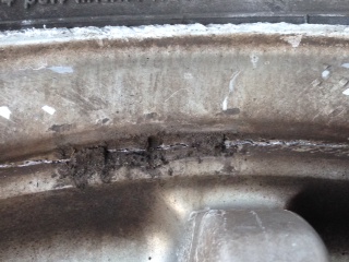

    Got my car checked out today. Signs of wheel crack (see picture) and was suggested to replace wheel. Any suggestions where to buy wheels? The mechanic is going to look for one in the junk yard.
    Apparently, the wheel bearings and struts are apparently fine. If that is the case, not sure what can cause the humming sound at relatively high speeds (>50 mph)?
    Removed the bad wheel and swapped it with one from rear. Put the donut spare on the rear. Now, while driving from the shop at low speeds while accelerating, I hear a whining noise (more like a cessna jet). Can the spare tire cause this since this noise was not present prior? I checked the air pressure on the spare - it was about 50-55 psi (suggested 60 pis) Also, the humming sound still exists - so, it appears that this sound is not due to the bad wheel. If so, from where?
    Any thoughts would be appreciated.

    Whirring noise would be from the wheel hub/bearings. I'd ask your mechanic how he determined that the hub/bearing is okay. The noise you are describing with the troubleshooting would tell me otherwise.

    Tires can make a whirring too. The best bet to check for the noise is to use a lift.

    The mechanic said he tried to shake the wheel bearing and apparently there was no play nor any sounds. He didn't see any bent struts either. Are the Prius wheel bearings different than normal cars that he may not know to diagnose?
    The one possibility he said was a bent tie rod that he said may be straightened out during alignment with a new wheel

    Thats what i figured his troubleshooting method was. Shaking the wheel isn't always a good indicator of a bad bearing.
    I'm not a mechanic but I've replaced a handful of bad hubs/bearings on my cars. None of my wheel assemblies had side to side play trying to shake the wheel.
    There are only a few parts that would cause the humming noise at speed. After a curb impact, the wheel hub/bearing is the most likely component if you rule out the wheel/tire.
    The tie rod is a good candidate. And would be cheaper to replace. It would throw off the alignment which could result in a hummm.

    If you would, please verify what type mechanic/business checked your vehicle out. Hitting a curb at 25 mph, and the wheel damage they say resulted, requires more than a visual and wheel wiggle to determine all damage caused by this impact.

    Put a new wheel in the left front and did wheel alignment. LF Camber is 0.6 (range 0.5 to -1.0), LR Camber is -0.9 (range -2.0 to -1.0), Front Cross Camber is 1.4 (range 0.8 to -0.8), Rear Cross Camber is 0.9 (range 0.5 to -0.5). Mechanic said these are minor deviations and should be ok. He also said bearings, tie rod are all ok. Apparently, he also test drove it before handing it over to me.
    Much better drive now - the very obvious periodic hummabove 50 mph is gone. But (a) the car still steers very slightly to the right when steering is held straight (b) maybe a very mild hmm at ~33 mph and (c) dull continous hmm (or a grind) at ~60 mph. Are these due to the slight misalignment? Thoughts and potential fixes would be appreciated. I am planning to take it back to the shop but I should be prepared so I am not taken for a ride. FYI - I got the wheel changed at the Toyota dealer since the original mechanic could not find, in reasonable time, an aftermarket wheel from the junk yard. Luckily, the dealer had a 25% sale on parts; so got the new wheel for ~$300.
