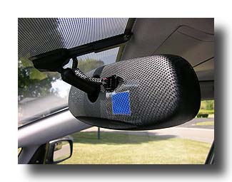

    Another trick that I learned on John 1701A's website:
    Put a piece of translucent material over the sensor. John used a piece of colored plastic like you might find on a report cover ( he used blue color). I used a piece of Kapton tape (yellow in color) because I had it handy at work. This helps to kick in the dimming at higher light levels.

    I know that mine does not work as well as those on my BMW and Mazda CX9 (also from Gentex). The difference is quite obvious. I just never bother to track it down. The autodimming works by comparing the two sensors (front and back). Put a tape on the front-facing sensor certainly will enhance the difference, therefore, work well.
